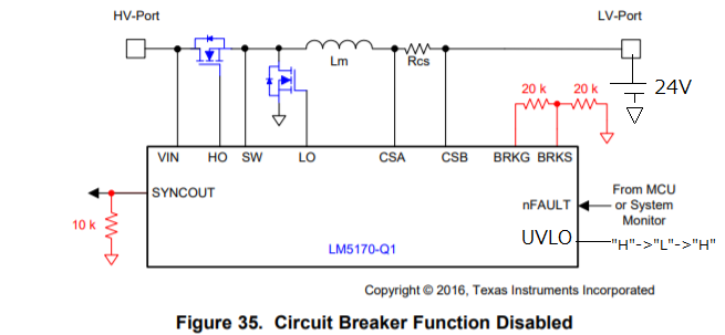

Is SYNCOUT pull down resister value needed 10kohm exactly?
When circuit breaker function is disabled, we need 10kohm pull down at SYNCOUT to GND. When four phase operation, SYNCOUT is connected SYNCIN of another LM5170-Q1. SYCIN pin has 100kohm internal resister. In this case, SYNCOUT pull down resister value will become around 9kohm.
Is there possibility circuit breaker function enabled when pull down resister value is 9kohm?
