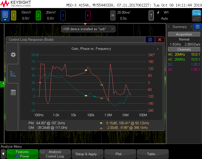

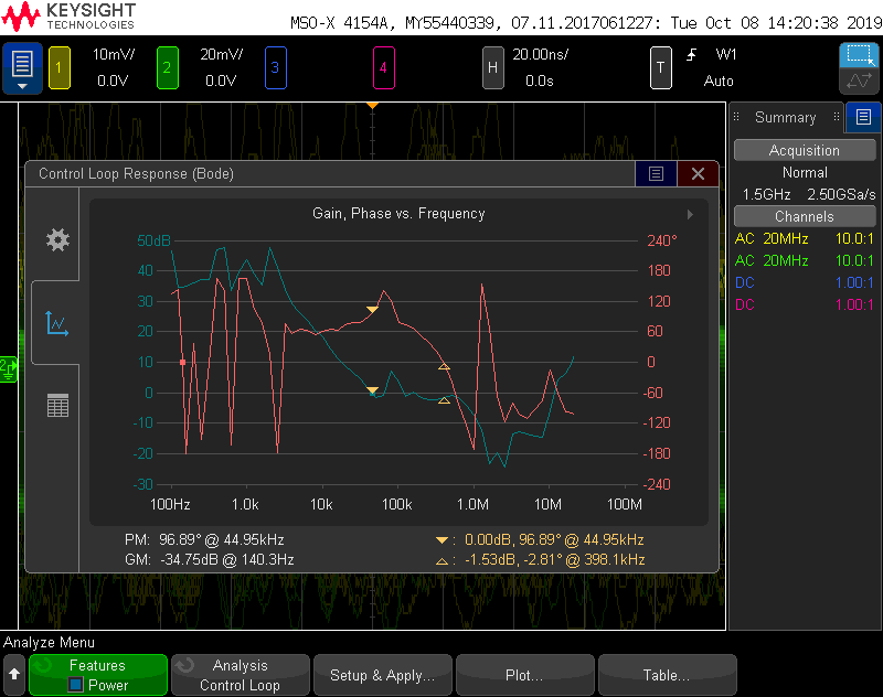

HI Team,
LM26420Q1XSQ/NOPB part for 3.3V (0.2A actual consumption) and 1.2V (0.45A actual consumption) generation on board.
1.2V Gain margin fails. Kindly share your feedback to improve this.
3.3V designed for 0.3A and 1.2V designed for 1.6A output current.
Vin is 5V.
3.3V: 3.3uH with a 22uF cout
1.2V: 1uH with 44uF CoutLM26420.pdfPFA loop stability reports with 100mV injection.
