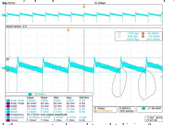

customer measured TPS563200 Step-Down Regulator ripple peak to peak 236mV very big. Customer have try measured other project board the same TPS563200 ripple peak to peak 64mV small, Can you help me to solve this problem?
Would you please review and provide your comments?
Here is the schematic and ripple measurement.

    It may be a combination of measuring technique load current and poor ground layout.  Accurate ripple measurement requires that you measure directly across the output capacitors using a very short GND pigtail less than 1 cm, or preferably "tip and ring" method.  This should eliminate the HF noise on your measurement.
    Alos, it appears you are operating in eco-mode.  Ripple will always be higher in eco-mode.
    It is important to connect the input capacitors directly across the VIN and GND pins.  This will require routing the SW node etch on the back side or internal layer.  See the datasheet for layout guidelines.

  • Hi SHH,
    This noise is caused by your measurement, please set the bandwidth of the oscilloscope to 20MHz, and measure the ripple as John said.

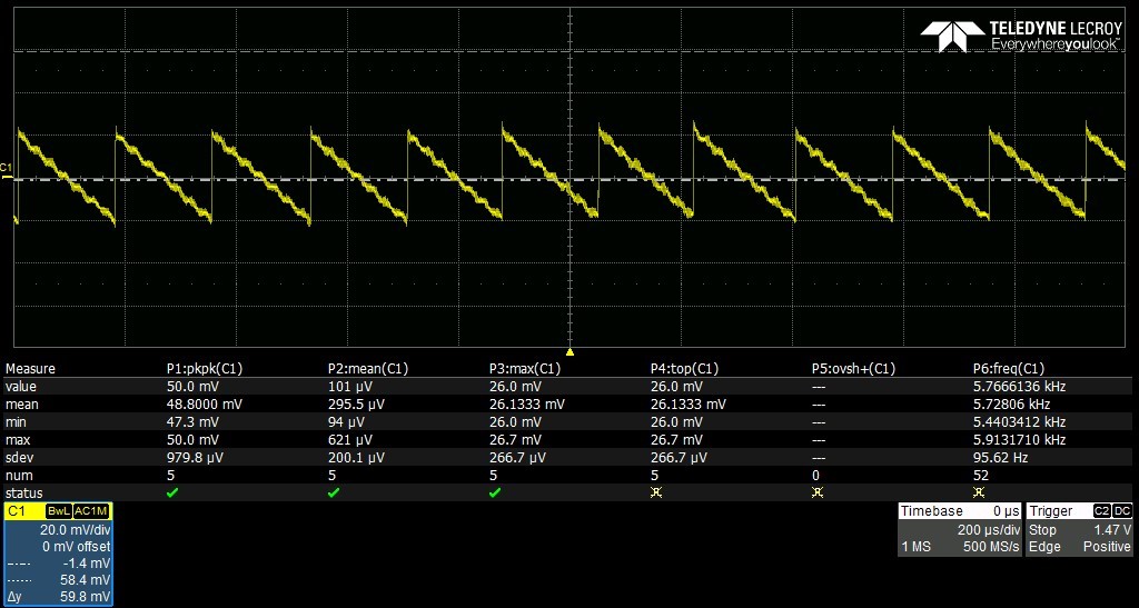

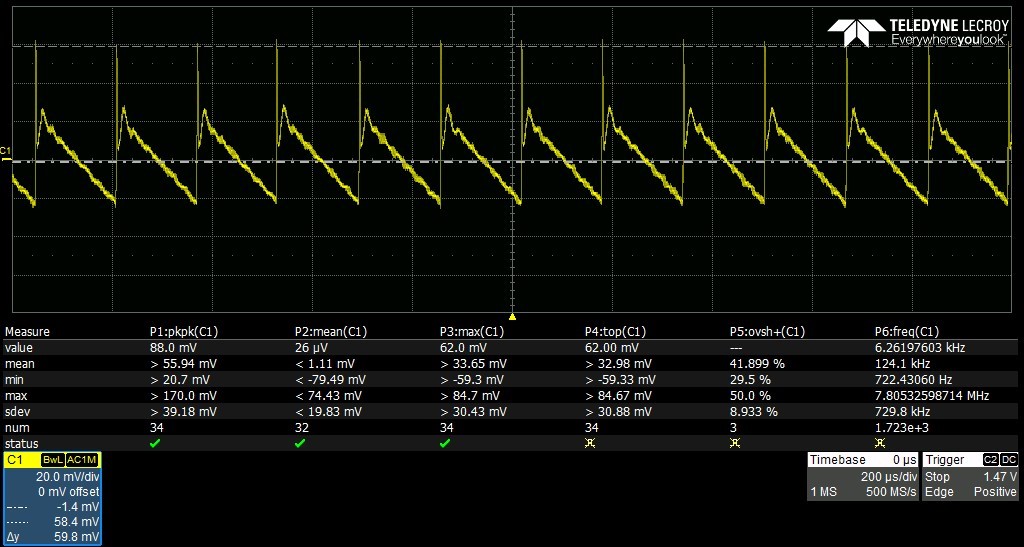

    customer still have questions regarding TPS563200, they changed components find output side bead affect peak to peak ripple, The peak to peak ripple is 88mV.
    See below pics, the question is why change bead to affect peak to peak ripple?
    Change FB602 bead to 0Ω
    Patty
    The bead can lead to the ringing, why does the customer want to add the bead? And can't they accept 88mV ripple?
