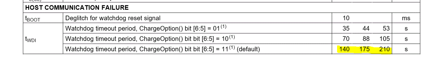

Charger IC disabling charging by setting ChargeCurrent to 0A, even though I am restarting WDT timer within 175sec. Steps I am following:
1) Enable charging
2) Enable WDT timer (175sec).
3) At 170sec, writing REG0x01[6:5] = 00 to disable watchdog timer and continue charging.
But charging is stopping. Tried even writing to MaxChargeVoltage() at 170sec but same issue observed. registers:

  • Hi There:
         There is part variation for 175s WD timer. Referring to our data sheet, the minimum timer could be 140sec shown below. Please try to disable the WD at 135s the charging should not stop any more.

  • Thanks Shishuo it worked.
    Please clarify why I can't use 175sec? please clarify on part variation.
    Part we are using - bq25703A I2C Multi-Chemistry Battery Buck-Boost Charge Controller With System Power Monitor and Processor Hot Monitor
    Thanks.
  • Hi There,
        175 second is the typical design value for time out period, but comes to real manufacture, there are silicon process variation and corner cases. We list the tolerance value here for customer's reference. similar to resistor and capacitor tolerance, the value you are targeting at is not necessary the final value you really achieve for each component.
    Shishuo
