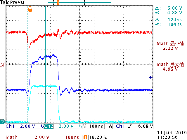

Hi Kris, thanks for the reply.
Additional information on the design.
Vin = 5V
Vout = 0.72V
Fsw = 880kHz
Iout max = 12A
I took the waveform at SW and BOOT pin. Red colour math function is the substraction of CH1 and CH2.
Sorry for bad resolution but it seems like the charging is complete before next cycle start.
May I know your opinion on this condition?
Best Regards
Naim
I think that looks fine, but I would recommend you test your design over for the full expected input voltage range (different duty cycle), load range, and temperature range you expect in your system to make sure you see good switching behavior.
