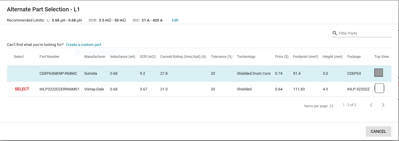

I plan to use TPS56C215.
Input voltage is 5V, output voltage is 1V, max current is supposed to be 9A.
I tried WEBENCH, and two inductor was listed in L1 Selection.
Murata FDUE0640-H-R24M was not listed there.
The specification of Isat is 19A.
FDUE0640-H-R24M is good enough for 9A output or not?
