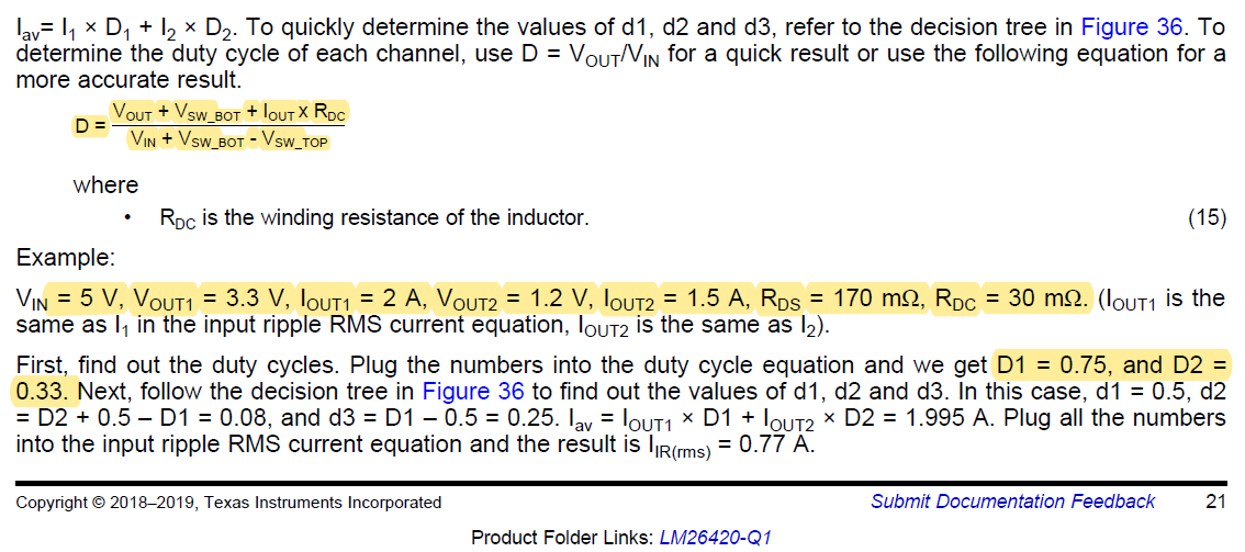

There is an example to calculatie the D1 and D2 in LM26420 datasheet, but i can not get the same result.
would you mind to explain the detail calculation for me?

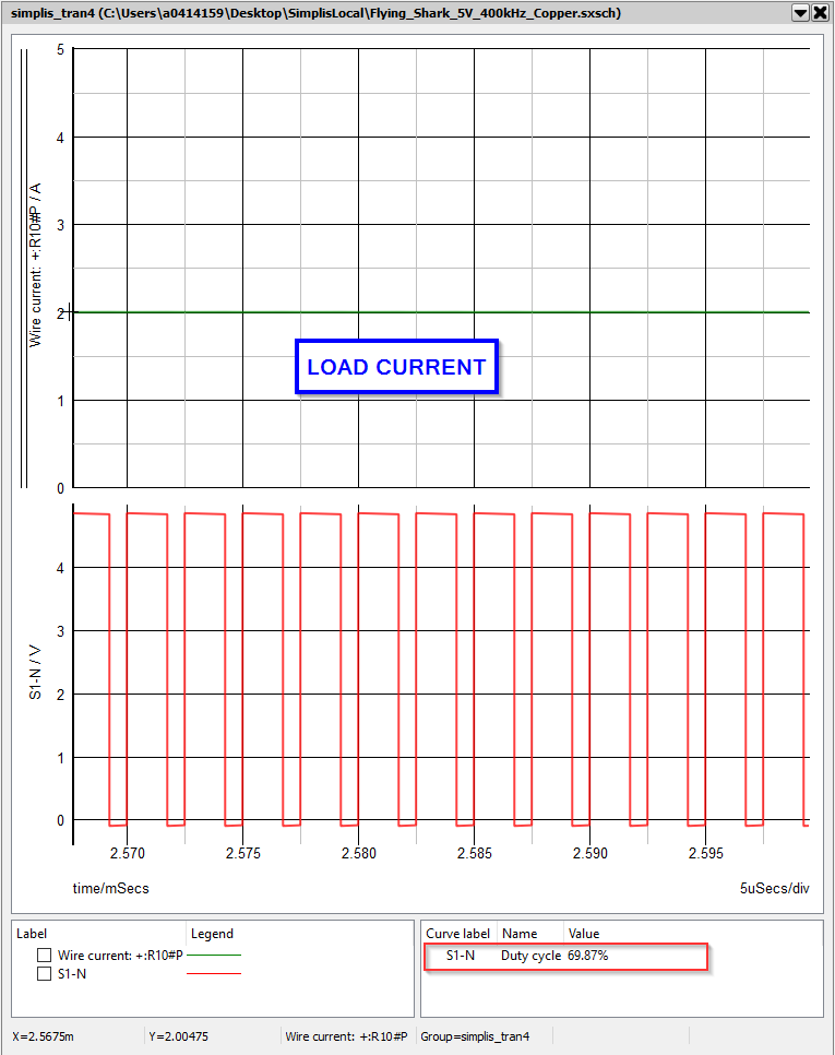

I am sorry that the result may not correct, but we can confirm that the formula is correct. you can see the calculate result meets the simulation result.
