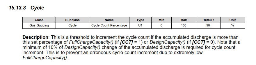

设置Cycle Count Percentage=90. 当充电时,累积放电量大于FullChargeCapacity()(如果[CCT] = 1)或DesignCapacity()(如果[CCT] = 0)的90%,则这是增加循环计数的阈值。是这样的吗

If CCT=1 then cycle count will increment if accumulated dsg is > 90% of FCC, if CCT=0, it uses 90% of design capacity.
