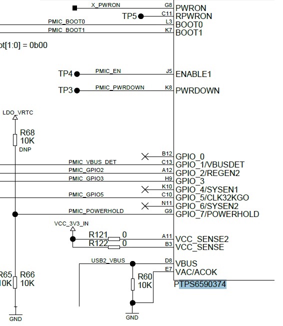

I'm using the PHYTEC's phyCORE-AM57x SOM, which uses the TPS6590374 as PMIC for the AM572x SOC.
The TPS6590374 has the connection of the x_PWRON pin connected to the switch and GPIO_7 connected to ground permanently making it powerON always from the switch.
I would like to remove the dependency of the switch for PWRON pin. So is it possible to do this with any register settings ?
Below is the part of circuit for reference:

  • Hi Nanjunda,
    Are you able to depopulate R66 and populate R68 on this board? You will not be able to change any register settings until the TPS6509374 part is powered up.
    I will also loop in the expert for this part to see if they have any further suggestions for this use case.
    Layne J
    There are two options for powering up the device (see ON Requests table in the datasheet). The first option is PWRON. This requires a push button followed by either a write to DEV_ON bit or pulling POWERHOLD high to keep the device on.
    The second option to turn the device on is to just use POWERHOLD (GPIO_7). In this case, no push button is needed and PWRON is left floating. POWERHOLD works like an enable signal. When it is pulled high, the device turns on. When pulled low, the device turns off.

    Hi Natasha/Layne,
    Thanks for the response. I too have read about this options in your other post replies. But is it right to keep the GPIO_7(POWERHOLD) always high, by mounting the R68 and removing R66 as suggested by Layne in my circuit? Will this permanently solve my problem?
    Do I need to do anything else along with above process?
    This is a old design and we are going with the production release for IC TPS6590374. So will be using this at this point of time.

  • Nanjunda,
    If POWERHOLD is always high, then it cannot be used to disable the device If you remove power while POWERHOLD is still high, all the rails will shut off at the same time, which is not a recommended solution for the processor. To address this issue, I recommend making sure that there is a valid "OFF Request" present.

  • Hi Natasha,
    We found a intermediate solution to replace the switch with a reset supervisory output. I hope that wouldn't create any issue for the whole power sequencing issue (Power ON or power down).

  • Hi Natasha,
    We have connected the active low supervisory IC output to PWRON pin and we have given the power input to one of the external powers (3.3V) on our board.
    We have set a delay of 5s through the capacitor option present on the supervisory. So ultimately we will get a low pulse for 5s and then the output of supervisory goes high. We have used TPS3808G33DBVR for this. The sense and VCC are connected to the same power signal.
    Please let us know if any issue with this setup.

  • Nanjunda,
    The long press signal on PWRON has a default of 12 seconds required for the pin to be low before the device will turn off. The shortest option (if set through I2C) is 6 seconds. I think you will need to adjust the supervisor reset signal if you want to use this to turn off the device.
    The other option is that if the supervisor stays lows when the voltage monitored is too low, than the reset signal could be connected to a pin such as RESET_IN to put the PMIC in standby when the input voltage is not sufficient. This would not need any delay to turn off the PMIC (where as the PWRON method requires 6-12 seconds).

  • Nanjunda,
    Your supervisor could just be connected to POWERHOLD (GPIO7) and then it would turn on the PMIC when the output of the supervisor went high, and turn off the PMIC if the output goes low from loss of power. Then, you wouldn't need to use PWRON and have these long delays.

  • Nanjunda,
    If you are using PWRON, you need a push button signal (high-low-high) to turn the device on, followed by POWERHOLD or DEV_ON going high within 8 seconds.
    To turn the device off, you need a long-press-key (where the PWRON pin is held low) for at least 12ms if using the default settings.
    If you want, you can configure the long press time to be 6ms by changing the settings in the LONG_PRESS_KEY register through I2C after startup.
