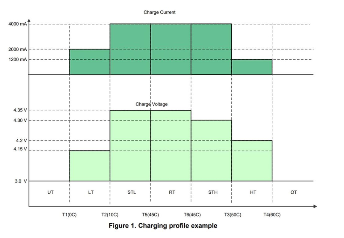

My end goal is to develop a battery management firmware with charger and gauge. I am looking for an example design.

Please see the example of battery charging profile. Based on such a given battery charging profile, I would like to write an application which charges the battery. I AM LOOKING FOR AN EXAMPLE. ideally with the charger ( bq25892) and the gauge (bq28z610). If not, any other charger and gauge is also fine.

    I am not aware of an application example with software that uses this charger and gauge.  Below are my thoughts on developing such an application:
    Hardware:
    Charger - use default application schematic except for TS pin being connected to NTC.  The TS pin needs matching resistors (e.g. RTOP=RBOTTOM=10k) from REGN to TS to GND.  This disables the charger's JEITA charge profile.
    Gauge - use default application schematic
    Software:
    Charger - I2C write to disable watchdog timer or set to periodically update WD timer bit and also disable charger termination (NOTE:  You can use the charger's termination feature and modified JEITA charge profile but when in JEITA warm, termination when Icharge <ITERM is disabled.)
    Charger - I2C write to set input current limit register if not correct per PSEL pin or ILIM resistor (can also disable ILIM resistor) to provide both SYS load current and BAT charge current (charge automatically prioritizes SYS load current over BAT charge current).
    Charger - I2C writes to set battery regulation voltage, charge current, etc.
    Charger - periodically monitor status/faults and make I2C register changes if necessary (charger is largely self sufficient/protective so minimum work here)
    Gauge - constantly monitor battery temp and use I2C write to change charger's battery regulation voltage or charge current per charge profile.
    Gauge - constantly monitor battery voltage and battery charge current as they reach battery regulation voltage and termination current then disable charger charging when reached
    Gauge - when battery voltage droops below a fixed value (e.g. VBATREG-200mV), I2C write to charger to resume charge.
    I hope this helps.
    Jeff

  • Redwood,
    JEITA is an acronym for an industry standard, LiIon charge profile that has been used for over 10 years..  It is the charge profile that you are proposing.  The BQ25892 uses a modified form of your profile. But if the gauge is imbedded in the pack, you cannot use the BQ25892 TS feature and must use matched resistors to disable the feature.
