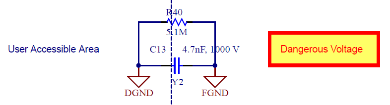

  • Hi Jason:
    Have you put a y-cap between GND and S-GND which may helpful for the high frequency EMI, you can try 1nF see whether it helpful.
    One more question is which standard you have to pass? normally CIPSER 22 CE will be under 30Mhz, when it above 30Mhz, commmon noise may become the major noise souce.

    Hi Daniel,
    Yes, I have a Y-cap on the board already. Sorry I forgot to show that on my schematic. It's on a different page.
    Designator Description Mfr MfrPN Digi-KeyPN
    C13 CAP CER 4700PF 1000VDC 300VAC Y5V RADIAL Vishay BC Components VY2472M41Y5VS63V7 BC3312-ND

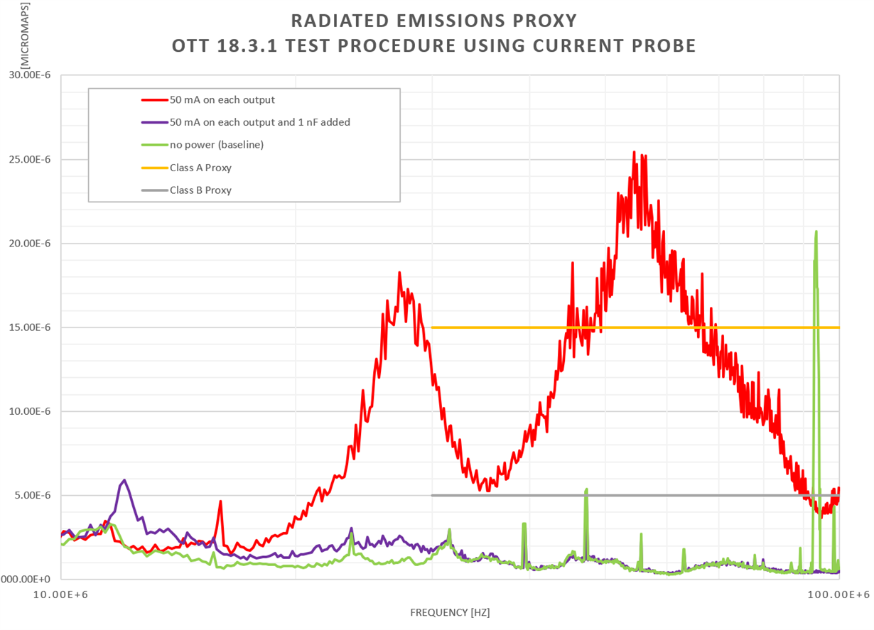

  • I should clarify some aspects of my testing. I am using a current probe to measure the common mode current as a proxy for radiated emissions. This test procedure is described in Henry Ott's book in 18.3.1

    The frequency range I selected is 30 MHz to 500 MHz. I didn't go lower since my resolution bandwidth is 100 kHz. I would need to do a second sweep at lower frequencies with more resolution. I didn't go higher than 500 MHz since my current probe's transfer impedance gives ineffective results above 500 MHz.
    I tested with a higher load and the results look worse
    Green - the device under test is not powered. Current measured is from the cable acting like an antenna picking things up in the room.
    Blue - The device is powered normally, minimal load on the +15 VF and +3.3 VF rails.
    Red - Same as blue but higher load on rails. Added 333 Ohm to +15 VF ~50 mA. Added 56 Ohm to +3.3 VF ~50 mA

  • Daniel Li14 said:
    4. change the Y cap to smaller value see any improvement.
    I added this capacitor, and it fixed the problem. Thank you for your suggestions - very helpful. My problem at 56 MHz is completely eliminated.
    CAP CER 1000PF 2KV X7R 1210
    Johanson Dielectrics Inc.
    202S41W102KV4E
    Digi-Key
    709-1040-1-ND
    Green - No power (baseline)
    Red - Powered, 1 nF not yet added
    Purple - Powered, 1 nF added
