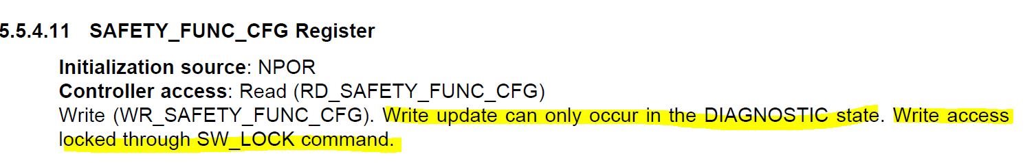

    For your first question, Kevin is correct.  SAFETY_CHECK_CTRL and all registers can be read in DIAGNOSTIC state.  All registers can be read in any the powered states including DIAGNOSTIC, ACTIVE and SAFE state.
    Only writing to some registers has the limitation of occurring only in DIAGNOSTIC state and some registers can be locked against writing with a software lock command. The write access limitations are highlighed in the register map of the datasheet if the specific register has a limitation against writing, an example is below.

    I assume you mean Device Status Flag Byte Response when you wrote "Device Status Flag".  This flag byte is simply a byte of information provided by the TPS65381A-Q1 with every SPI frame (output).  This byte does not have any impact on the register write restrictions.  Register write restrictions (for writable registers) that have restrictions are based on the device state and the lock/un-lock command as outlined register by register in the Write section of the register's Controller acces description.  One example of this is below from the DEV_CFG1 register:
    Controller access:
    Read (RD_DEV_CFG1)
    Write (WR_DEV_CFG1). Write update can only occur in the DIAGNOSTIC state. Write access locked through SW_LOCK command.
