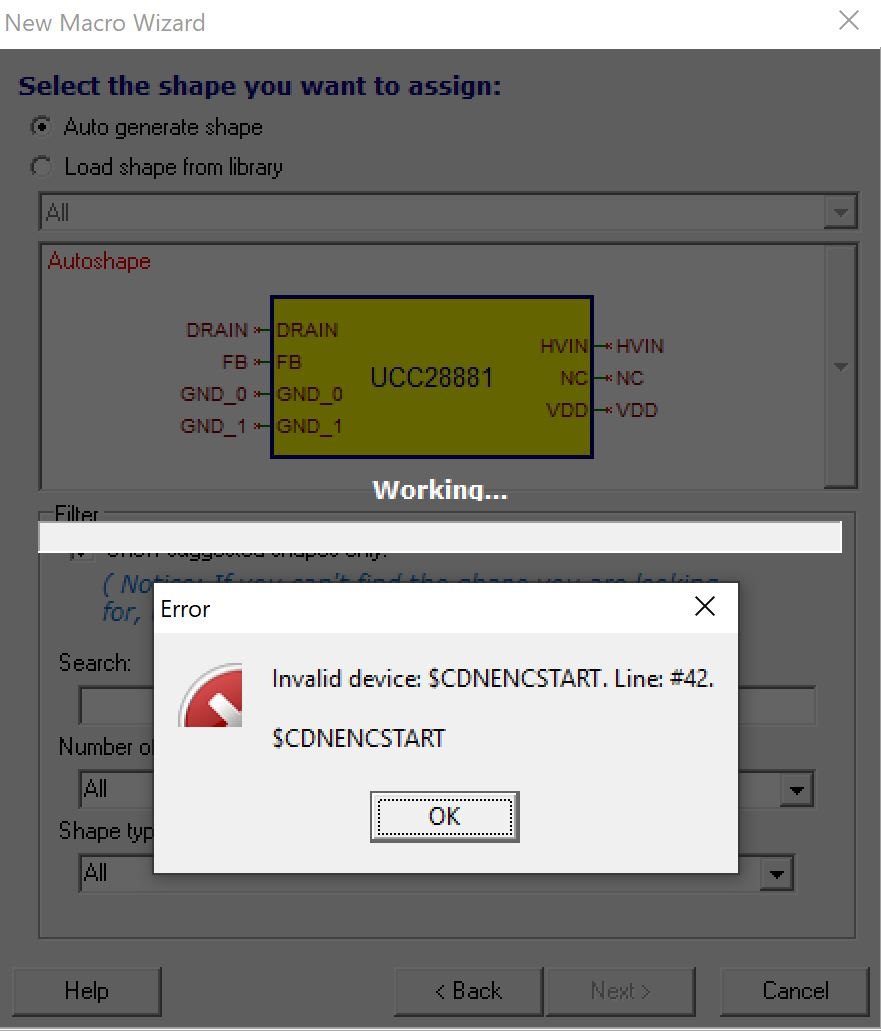

    for simulation model, i tried to use .LIB file via TINA TI function as "New Macro Wizard".
    but i couldnt import it.
    do you know how we could import it smoothly?
    are there any specific way to import the file which is encrypted file into TINA TI?
  • Takahashi-san
    You cannot import an encrypted SPICE file into TINA.  I have sent you an email on how to get access to an unencrypted model.
