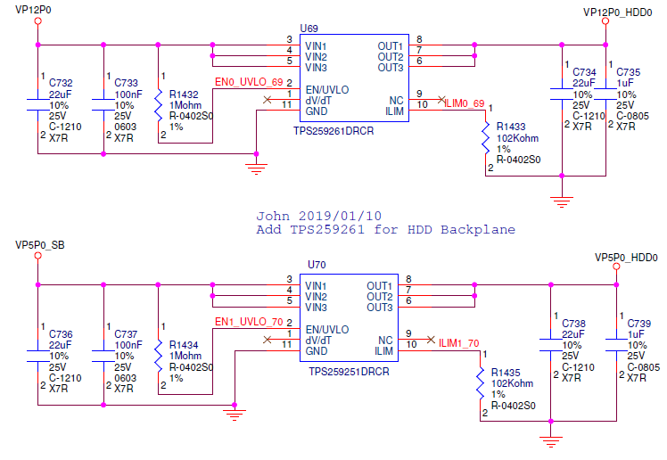

Our design shows in the attached.
Could you help to check the EN/UVLO pin connection is ok or not?
Both TPS259261 and TPS259251 V(UV) is 4.3V, is it right?
