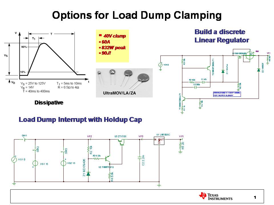

    I have one more question. Regarding the protection circuit for load dump and cold cranking, is there a single IC solution? I also tried looking for app notes in the TI website on protection circuit for automotive using discretes but can't find anything useful. Could someone point me to the source if there is one?
    Poh Leong
  • We do not have any devices designed specifically for load dump protection. We do have devices that are load sump tolerant due to their higher supply voltage ranges. We typically customers implement load dump protection using a MOV or similar device. I attached a slide with some options that have been seen.
