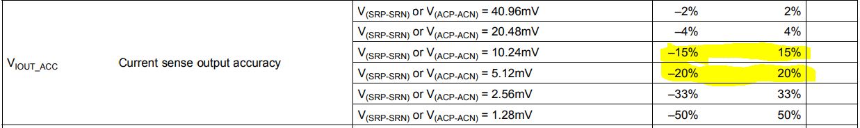

3. My customer tested with Iout to sense the charge current and IOUT pin is connected to ADC of MCU, and the charge current read by gauge BQ4050 and multimeter are both 750mA, but MCU read the current to be 896mA, the error is about 19%, which exceeds the spec in the datasheet (sense resistor=10mOhm, the same as in the datasheet). What may cause the problem?
charge current read by gauge/multimeter charge current read by MCU through IOUT pin
750mA 896mA
151mA 281mA
