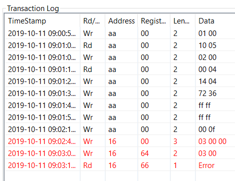

    Using the GDK, Advanced Comm I2C tab, I am trying to duplicate exactly what the .df.fs tells to me to.
    Below is the .df.fs portion I am trying to duplicate (the very beginning):
    ;Verify Existing Firmware Version
    W: AA 00 01 00
    C: AA 00 10 05
    W: AA 00 02 00
    C: AA 00 00 04
    ;Unseal device
    W: AA 00 14 04
    W: AA 00 72 36
    W: AA 00 FF FF
    W: AA 00 FF FF
    X: 1000
    ;Go To ROM Mode
    W: AA 00 00 0F
    X: 1000
    ;Data Block
    W: 16 00 03 00 00
    W: 16 64 03 00
    X: 20
    C: 16 66 00
    Below see the screenshot of the Transaction Log, from GDK:
    Every command being sent to address 0xAA receives an ACK. The red commands, being sent to address 0x16 get a NACK back from the device. The writes are not implemented, and no data is sent back during the read/compare command.
    I'm assuming the ROM mode I2C address is incorrect. Can you please look into this?
    There is also the possibility that, despite the NACK, the writes are working, but if that is the case, I can never actually execute the read/compare command, as I need to get data back from the device.
    Also, it appears the Enter ROM command works (it's not red, a NACK is not received). However, when I send a dummy command (W: AA 00 01 11) that is not mapped to a valid command in the datasheet, it also appear black and say it was executed successfully. Therefore, I cannot rule out the fact that the Enter ROM command is indeed incorrect.
    Can you please help me figure out why these ROM mode commands are not working?
    Rob
    Using a program to probe all the available devices on the I2C communication bus, I can confirm that no new addresses appear after the Enter ROM command. I can also confirm that the address of the BQ27510 (7b 0x55) does not change. Something is incorrect with either the Enter ROM command, or the ROM mode I2C address.
    Please advise, thanks.

  • Hi Rob
    The addresses are different in rom and firmware mode-AA for firmware mode and 16 for RoOM. The fact that you are getting an NACK after sending the commands to the ROM address means that you are not in ROM mode. Check to make sure your device is not sealed as that is the main reason you will not be able to enter ROM mode. Can you take a screen shot of the register window and attach here. Are you able to program the flashstream file using bqstudio?
