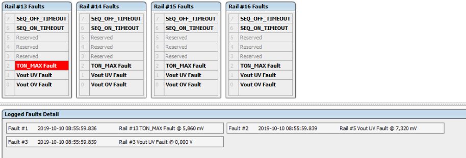

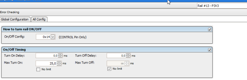

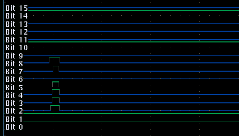

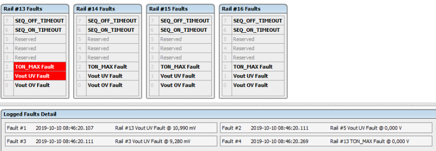

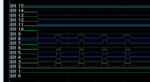

I came back on my 64 pins eval board with an UCD90160A to understand the problem on rail 13 P3V3 (bit 6 on the logic analyzer, bit 2 to 5 are other rails enables) :
  • A resequence occurs when I disconnect the UCD EN ouput from the UCD MON input. At this time a Vout UV fault occurs which produce a resequence (rail 13 disconnected)
  • A resequence does not happen, if I start the board with an already disconnected couple EN-MON in which case only a TON_MAX fault occurs.

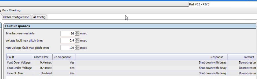

In fusion software I have programmed a fault response on both faults TON_MAX and UVF.
Could please help me to solve this problem : resequence on TON_MAX.

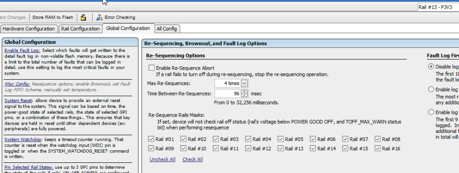

  • Hello

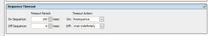

    I would suggest to set the resequencing time to unlimited instead of 4 time and also increase the sequencing interval to try? if this does not help,  please share your project file.
    Yihe
  • Hello Yihe,
    Following your advices I was able to have some resequencing on the eval board.
    But I cannot get it to resequence on our board, which of course have different timing because it based on real supplies.
    Is there a secure way to share our project file.
    L.B.

  • Hello Yihe,
    Your advices allow me to have a first working version. I went back on evaluation board which allow me to correct some little mistakes and then I was able to have it working on my real board. I validated it today, I'm waiting now for internal feedback.
