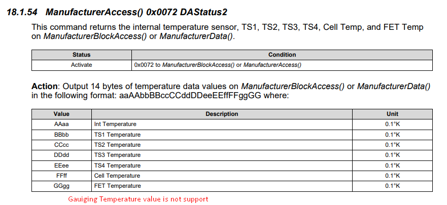

Hello;
In the reference manual on page 130, the ManufacturerAccess () 0x0072 DAStatus2 header says that 14-bit data is being sent. But this register is sending 16-bit data. Information in indices 15 and 16 Gauging temp.
Sincelery
