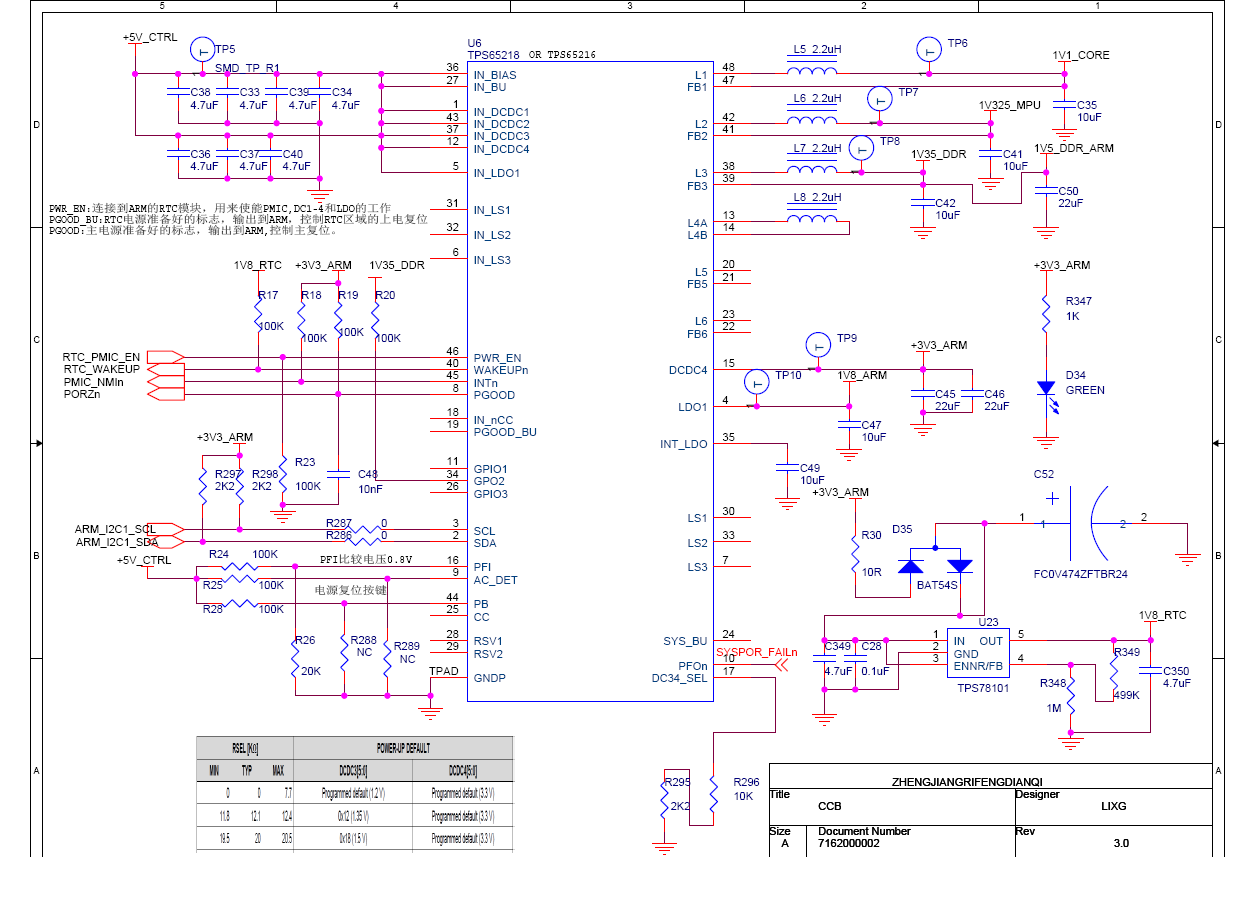

Use tps65216 to supply power to AM4377. The circuit diagram is as follows
problem description
Power output cycall by cycall: first LDO1\DCDC3\DCDC4 can be output to the set value, when DCDC1\DCDC2 output reaches the set value, all the power supply falls to 0V, and then repeat the above phenomenon in a 500ms cycle. The value of ENABLE1 Register is 0x3C read through the I2C interface, The results show that DCDC1\DCDC2 is not enabled.
