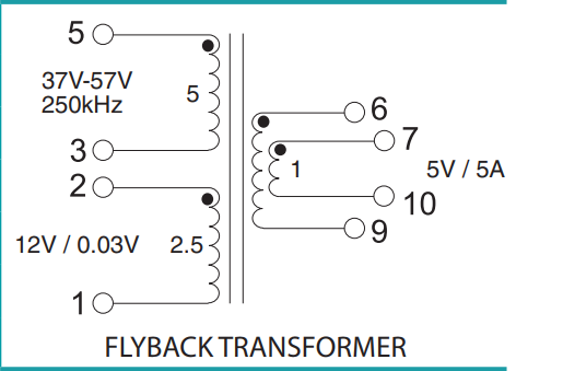

Hello! In the TPS23756EVM reference board, I use PA2369NL see image below, How can I change other
parameters? Now my Board can't work, the gate signal up close to 78%.

Thank you very much for your question, and for providing your schematic. I would like to clarify, did you use the TPS23756EVM and then replace the transformer, or are you stating that the schematic is based on the EVM?
My initial comments on the schematic is that the pulse transformer, T3, appears to be in a different place than the EVM. I would suggest moving it to be between source and ground of Q4.
