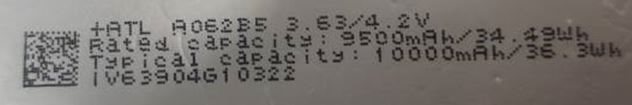

Customer is looking NVDC charger.
Would you please recommend the proper solution based on the requirement?
1. support two series battery (voltage 7.5V).
2、suport NVDC . if the adaptor power is not enough, charger can provide the power from adaptor and battery at the same time

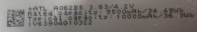

Here is the battery spec.
BR,
SHH
  • Hi SHH,
    If the input voltage is < 8.4V, then I recommend the BQ25882 in WCSP or BQ25883 in QFN.  If cell balancing is required, then BQ25887.  If no I2C is available then BQ25886.
