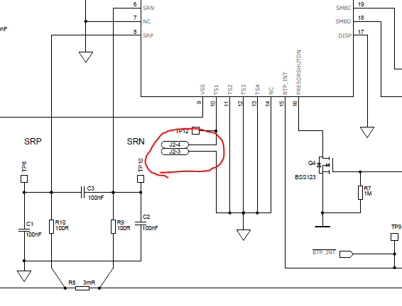

  • Hello Martin,
    Can you provide us a block diagram of how you have your thermistors setup here?
  • Just a typical 10k NTC is connencted to this Pins. But I can't understand, how that information could be nessesary for the question of the calibration issue from the bqProduction program.
