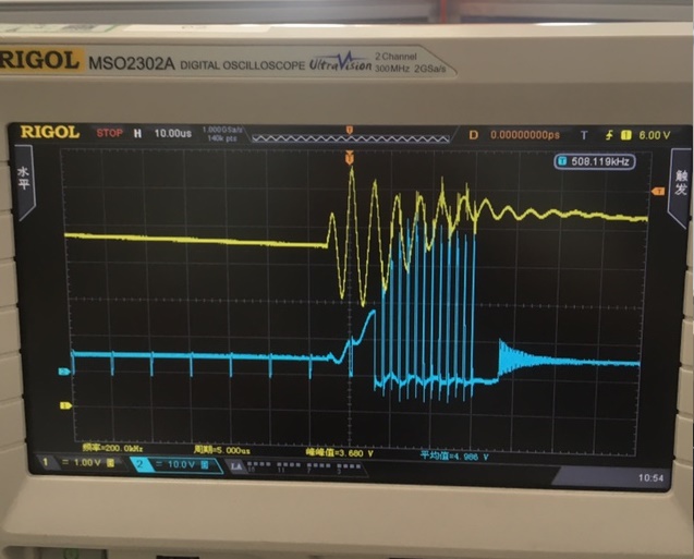

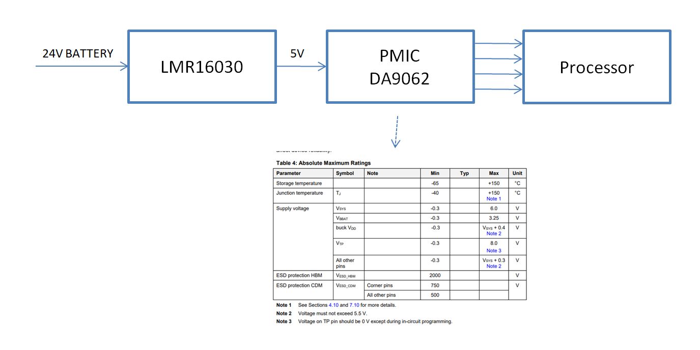

Hi ,
     Customer's product is using in truck the supply voltage is 24v from battery. At car production line when they assemble the board  it's high probability to damage the PMIC as below block diagram.

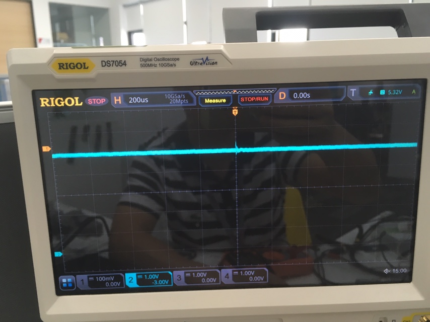

Customer can reproduce PMIC damage issue in their lab by discontinuous contact  24v input. Picture 2 and 3 were scope capture。 What can we do to reduce the lmr16030 output spike when hot swap?
