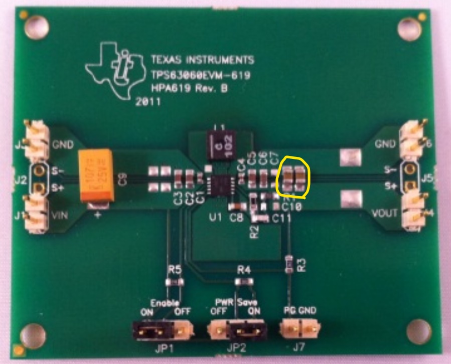

Dear Support team,
I found 2 additional output capacitor undefined in schematic at actual EVM.
Could you let me know the specification of them?

Hi Hirokazu:
Sorry that the B version is too old, and I have no information here. Please wait me to check with team if there have any idea.
Now we have a new version, and the Cap in your red cycle are "CAP CER 22UF 10V X5R 0805 ±20% "
