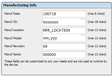

  • Hi Yihe,
      Actually we had configured both MFR_Date and MFR_Revision as below figure.
    Do you see any difference to cause this problem we encountered?
    What I saw is we used all 6 chars of MFR_Date and only 2 chars of MFR_Revision.
  • Hi Yihe,
      We have tried to fill all 12chars of MFR_Revision and the test result is same as what we saw in MFR_Date. which is PMBus_Alert# be asserted if not read the entire block.
    Our question is this a limitation of UCD90120A or defined behavior from standard(PMBus)?
