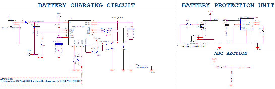

Hello team,
We are using BQ24072 IC to charge a LI-ion 18650 battery, capacity is 1400mAh.
Kindly find the schematic below :
The CE pin is low.

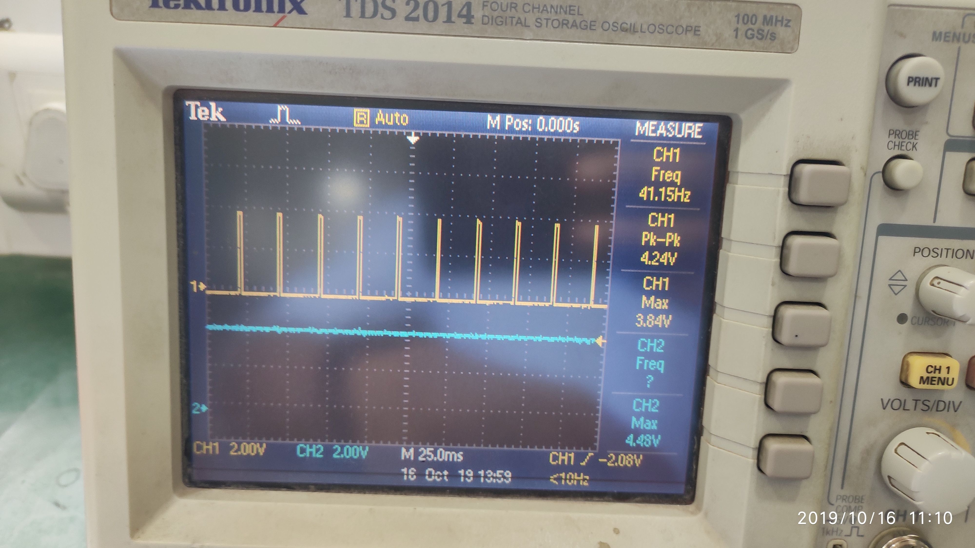

While the battery voltage is below 4.0V the CHG pin stays low and when the battery voltage exceeds the CHG pin start giving pulses.
About the pulses:
1) On time : 2ms
2) Off time : 19ms
So in our application MCU finds it difficult to understand the exact status of CHG pin.
We tested 10 device and out of 10 three device have issues other 7 is working fine.
Please review the schematic and let me know if i am missing anyting.
