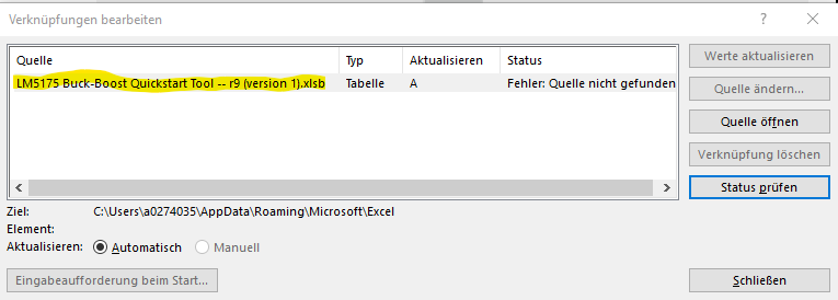

    Thanks for your quick support and presenting the link to the design tool. I understood you just want me to start with changing R78/R76 ratio, right? To verify, I downloaded the tool. Not sure everything is correct - when I open the spreadsheet Excel complains about an external binary source not being present: "LM5175 Buck-Boost Quickstart Tool -- r9 (version1).xlsb".  I cannot find this file in the zipped Folder which I download..The Zip file only contains LM5170DESIGN-CALC.xlsx.
    Although despite this the sheet seems to work without the mentioned file, I am not sure everything is ok. E.g. when I increase the number of phases in the tool, the main inductor value also increases. I would have expected a decrease of the value… Can you briefly comment on this?

  • Hi Martin,
    Thanks for downloading the quick-start calculator. I have never seen that error before but the calculator should work fine without the binary file it says it is missing.
    To change the output voltage you have the correct resistors. These just need to be changed to  move the output voltage up.
    If the number of phases increased the current conducted per phase decreases. Assuming that the same inductor current ripple ratio stays the same then the inductance value needs to increase to keep the ripple ratio the same. This is why the inductance value increases.
