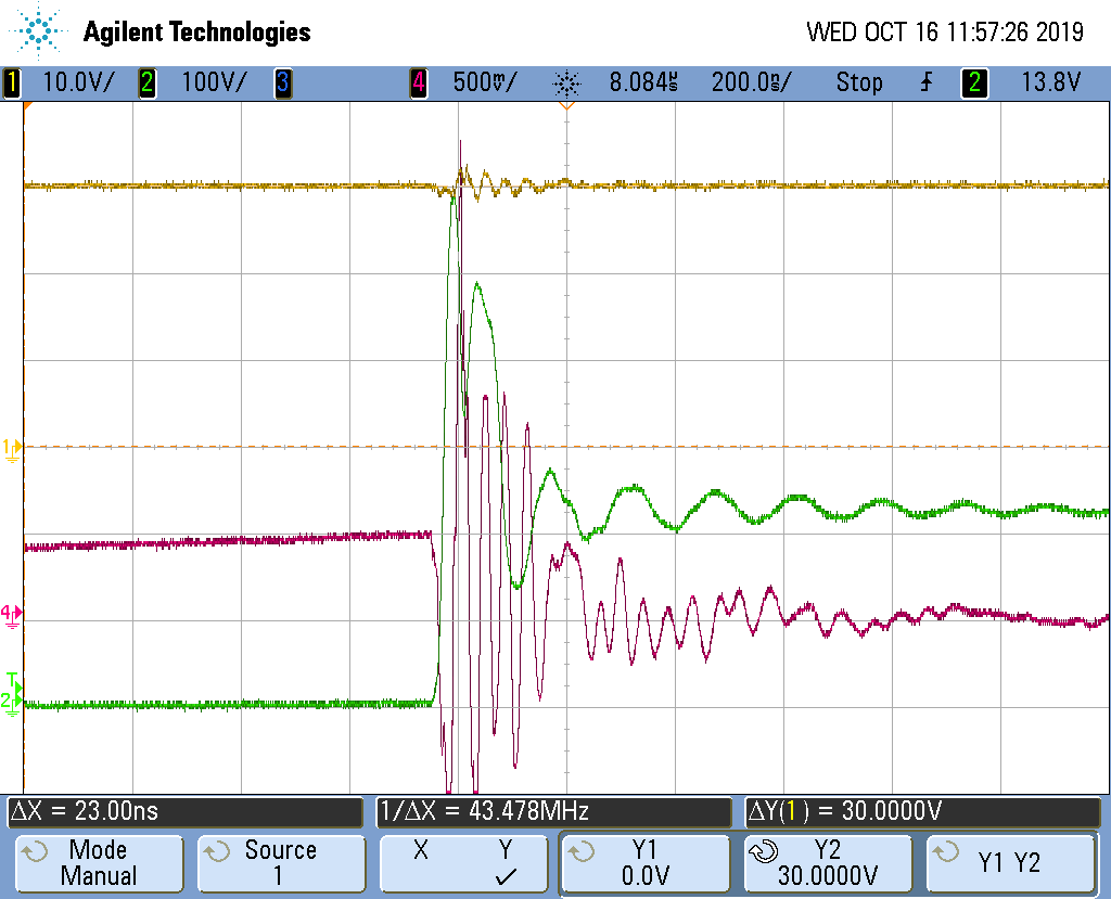

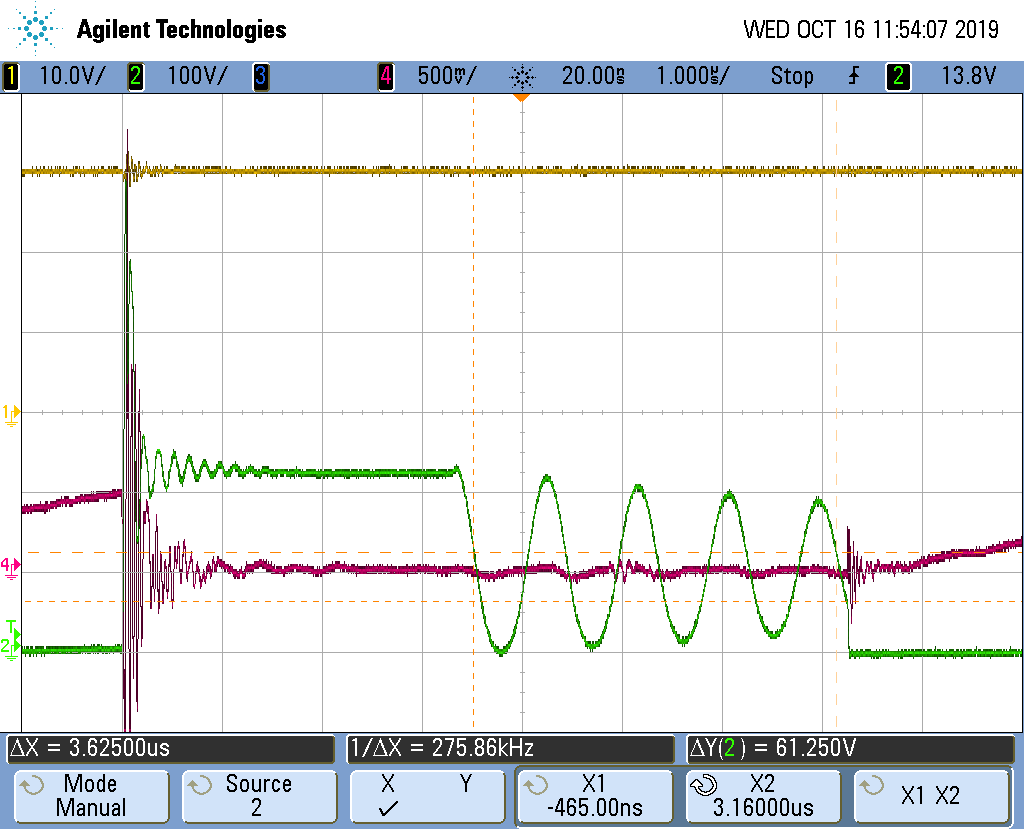

    (Yellow line_Vdd of UCC 28780; Green line_Vsw; Red line_Voltage between Rcs)
    Unfortunately, the test board is broken in the following debugging process when the load-current is up to 2.4A. Both the low-side switch and UCC 28780 are burnt out. From the test waveform, I found that the VDD was up to 30V at the load current of 2.4A. It seems that the Vdd would be charged up to a higher level in the LPM. In my case, the rising Vdd directly damaged the UCC 28780. The low-side switch is burnt out and I guess it is due to the short-circuit condition or the over-current stress.
    In the beginning, the circuit is always operating at AAM mode, but suddenly, at 2.4A load condition, the circuit turns to the DCM mode, with large voltage spikes at the Vsw. The corresponding waveform is in the attached files, with 30V of VDD and large voltage spikes at Vsw.

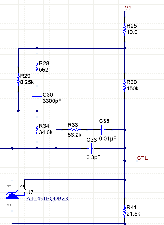

    In addition, the R25 you have indicated is in the output loop. Could you tell me the reasons that the increase of R25 could make a difference?
    Furthermore, I have some questions about the Transition-mode control of UCC 28780. Usually, in the SBP and LPM, the PWMH is disabled and the low-side switch behaves like the valley-switching flyback, the low-side switch is turned on after 20ns delay with ZCD of VS pin (from 4.0V to -0.1V). However, I found that sometimes the Fsw would have a minimum limitation such as 125kHz. After low-side switch is turned off, if the tsw is smaller than 8us, even though the VSW across the Vbulk, the QL would not be turned on. But it has not been indicated in the datasheet.
    In addition, in AAM mode, when the low-side QL be turned on based on ZCD or Vth(sws)? What is the relationship between these two criteria to turn on the low-side switch?

  • The reference designator R25 actually should be R35 in TIDA-01622, not from your schematics as I do not have your schematics. Can you please forward your schematics to me for a review?
