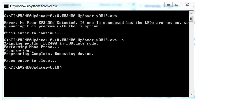

    I tried uninstalling and installing bqs and when I tried to run the EV2400 updater I get the following message; "Error: No Free EV2400s Detected. If one is connected but the LEDs are not on, try running this program with the -s option.".  One is connect and all LEDs are on so now I appear to be further behind...  Any ideas?

  • Hi Vernon,
    Try running the ev2400 in -s mode. as shown in the snippet

  • Hi Onyx,
    I've been out of town and now that I'm back here are the Bit Registers you requested and the results of me running in the -s mode.

  • Hi Onyx,
    My problem has really put a kink in my design work so I just purchased another EV2400.
    Without running the EV2400Updater I was getting the same results and out of curiosity I connected the EV2400 directly to PC's USB port where previously I was connecting through a USB 3.0 HUB. It works!  Now I have to figure out how to learn the Battery Management Studio GUI.
    Turns out I didn't need to buy the second EV2400 since the original one works when initialized while connected directly to the PC's USB port.
    Thanks so much for all your help!!
