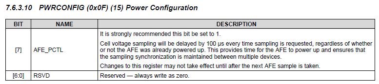

I have one question about pl455 registers. (Image below) bq76PL455A-Q1 datasheet recommends set AFE_PCTL to 1. Is it necessary if I use an EM1402EVM?

Hi user,
The recommendation stands regardless of if you are using the EM1402EVM or not, it is a strong recommendation for sampling synchronization rather than a necessary requirement.
Taylor
