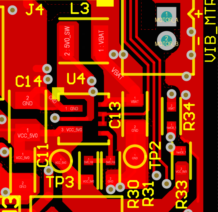

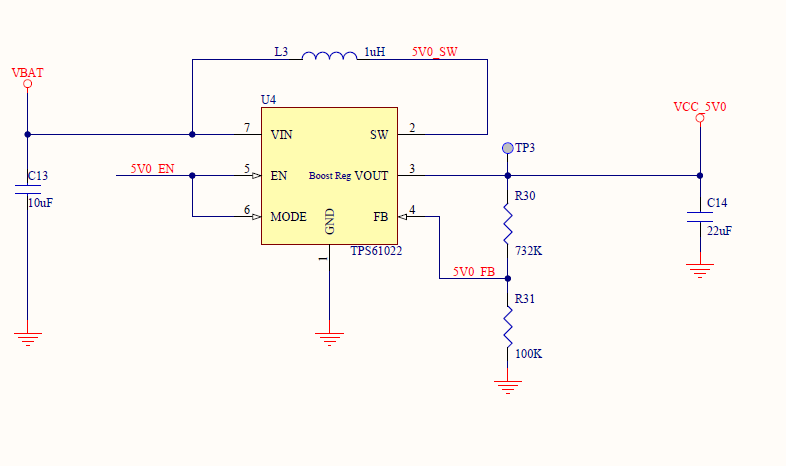

  • Hi Hari,
    Could you share the schematic and layout?
    Have you capture SW, Vout pin waveform with digital oscilloscope?
  • Hi Zack
    I am attaching the sections of Schematics and Layout containing the power supply circuit. Please find the attachments.
    Also, I didn't capture SW and Vout pin waveform with digital oscilloscope.  W, Vout
  • Hi Hari,
    For 5Vout/2A applications, TI recommends using effective output capacitance bigger than 20uF. So please use 2*22uF output capacitor in parallel or use a higher value ceramic output capacitor for C14.
    The schematic doesn't show me the inductor part number. What's the saturation current spec of the inductor L3? You may need to use a Isat higher than 8A inductor.

  • Hi Hari,
    What's the capacitor C14 part number (or value) are you using? Do you have VLP8040T-1R0N (1uH) on hand and try it again? The reason is 2.2uH inductor will let the right half plane zero lower in this condition, causing a lower phase margin and gain margin.
    Does the damage issue happen on several board or only this one? Can you use digital oscilloscope to capture SW, Vout pin waveform?

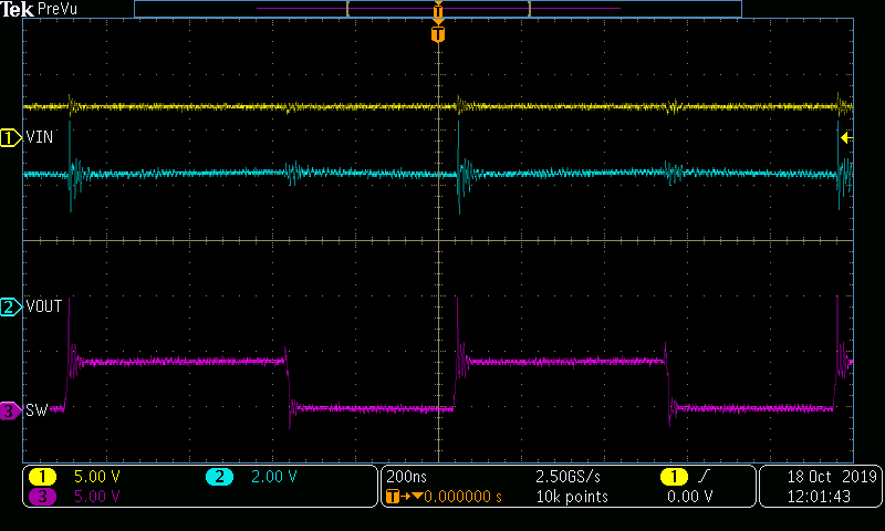

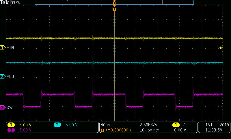

  • Hi Zack,
    I have probed VIN, SW and VOUT under the following conditions.1. Vin =3.3V , Iout = 2A
    2. Vin =2.9V , Iout = 1.8A
    Then I increased the Iout to 2A  when  Vin =2.9V and the switcher get damaged.
    I am attaching the observed waveforms under the above-mentioned conditions.
    Since all the switchers in stock were damaged I have ordered few switchers and the Inductor that you mentioned in the previous post (1.0uH inductor with a current rating higher than 8A).
    I shall let you know the results after checking with them once it is received.
  • Hi Hari,
    I try to replicate the unit failure on EVM. I also found instability behavior with inductor 2.2uH and Cout C2012X5R1A226M085AC when input voltage is 2.4V and Iout=1.4A. SW, Vout pins voltage may rings high to 7.5-8V, higher than the absolute maximum voltage rating 7V.
    So select a 1uH inductor and use 4*C2012X5R1A226M085AC as output capacitance. Hope that help you.
