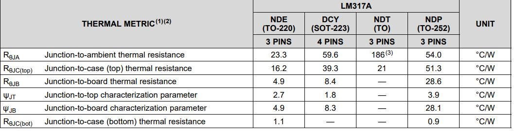

The current limit is set as shown in the table above. Please tell us why the difference between TO-220, TO-252, and SOT-223 appears.

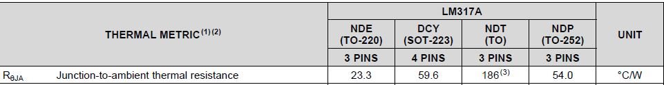

I thought that it was different due to the problem of heat capacity and checked the specifications in the table below, but when I look at this,
I can not understand why the Current Limit in SOT-223 is larger than that in TO-252 because RθJA value is almost the same between SOT-223 and TO-252 .
Y.Ottey
  • Dear all,
    When checking the data sheet again, the value of ψ in the table below is smaller for SOT223 than for TO-252. I think this is the reason.
    Is there anything else you can think of as a reason?
    Y.Ottey
  • Hi Y.Ottey,
    This is an interesting question.
    I believe the answer also lies with the ψ parameters.
    The junction to board characterization parameter is much better for the SOT-223 than the TO-252 package.
    Most of the heat is dissipated through the board, so a lower thermal impedance from the junction to the board will allow much larger current through the device.
