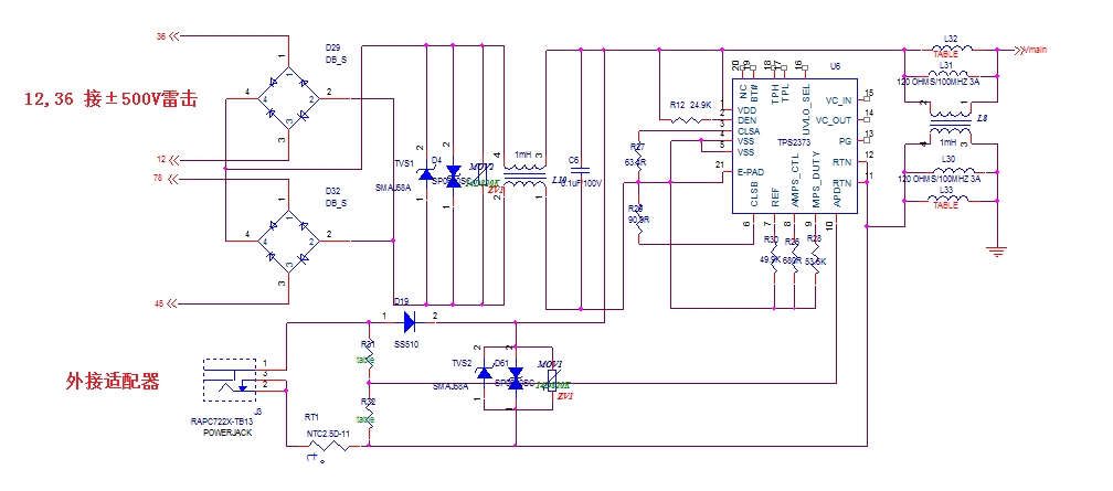

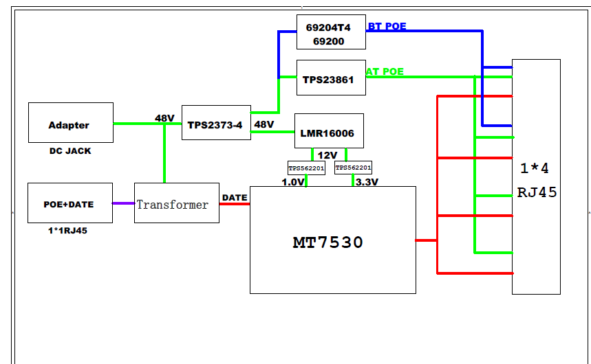

Hi TI expert:
i use the TPS2373+ TPS23861 in my PoE project,
When there is no DC JACK input, add the surge  ±4KV on RJ 45 12/36 Port, the testing is pass.
but when use the DC JACK, and the only add the surge ±0.5KV on RJ45 12/36 Port,the testing is fail, and the TPS2373 damage.
Can you give me some advice to avoid it, thank.
Below is the SCH and project block,
  • Hi Jack,
    The surge is worse when adapter is connected because the pass FET is OFF when adapter is plugged in. So the stress on the pass FET is higher.
    Can you try the solution recommended in the below app note? It has recommended components for up to 4kV surge testing.
