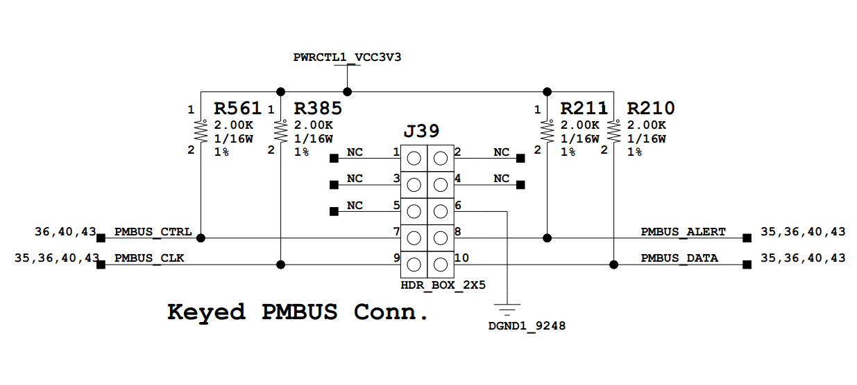

I am using Xilinx's KC705 development board and there are three UCD9248 ICs on it. Most of the time when I power the board, these ICs don't startup. Therefore, board doesn't startup either. They designed the board(UCD9248 part) exactly what datasheet says. I think it is beacause of the reset pin. Because when I touch the reset pin, IC goes into reset state and hold until I touch next time. I uploaded the schematic of this part. How can I fix this problem.
Thanks in advance.
Canberk

  • Unfortunately I don't have PMBUS cable, but I will get asap.
    PMBUS connector on the board doesn't connect to any host. On the design they connect PMBUS control pin to UCD9248's 3V3 output with 2k pull-up resistor. I added the schematic of this part. I measure 0V  on the PMBus-control pin when it doesn't startup, and I measure 3V4 when it starts-up normally.
    Based on what you observed, the rails are controlled by PMBUS_CTRL pin voltage.
    The PMBUS_CTRL pin voltage is determined by external circuit.
    Sorry I'm not familiar with Xilinx's KC705 development board, you may need to contact Xilinx why PMBUS_CTRL pin voltage is low when the board is powered on.

  • Thank you very much for help, Qian,
    PMBUS_CTRL pin isn't connected to anything other than UCD9248's 3V3 output(pull-up with 2k resistor). Is it possible that UCD9248 may make this pin 0V? Otherwise these IC's may be damaged.

  • Hi Canberk,
    Can you check PWRCTL1_VCC3V3 voltage when PMBUS_CTRL pin voltage is low?
    Qian
  • Hi Qian,
    I checked it when it happened, it was still 3V3. How touching reset pin solve this issue, I don't know.
    I have ordered TI's USB -interface adopter to reprogramme chips, it if helps.
