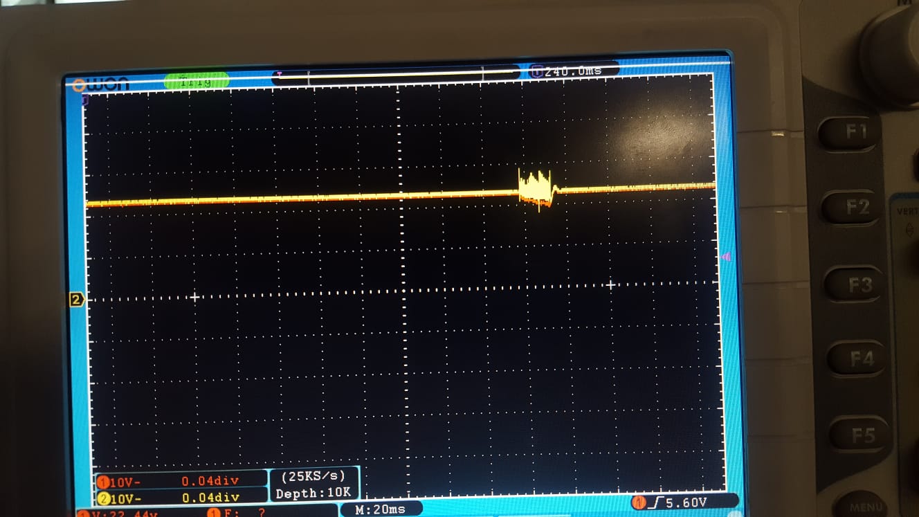

Hi TI forum,
I need to design an EFT filtering circuitry in front of the DC-DC power line to suppress industrial transients, according to standart IEC 61000-4-4.
I need performance criteria A (device is not affected any of the transients) suppression for at least level 3 (2 kV @ 5 kHz) eft bursts in my design.
So far with the help of the basic elements I can suppress level 1 transient waves (0.5 kV @ 5 kHz). In the design I use two ferrite beads one in the voltage side and one in the ground. Then I added varistor, tvs and common mode choke in parallel and series inductors again one in voltage side and one in the ground. Lastly I added capacitor block consists of 7 caps in parallel decreasing of factor 10, from 1000 uf to 1nf.
What improvements should I do to suppress these level 2 transients with criteria A performance?

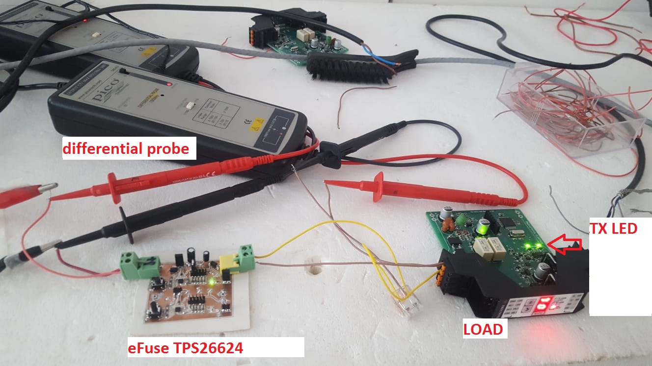

We asked this question before and one of TI's workers recommended eFuses. After that I tried using efuse with tvs but I can't filter any transient waves with this. I used TPS26624 - EVM design. Increasing input capacitance(1uF to 10uF) helped a little bit but not much.
I'm using 24VDC input, 30V bipolar tvs diode(SMAJ30CA, in and out side), 10uF input side capacitor and 2.2uF output side capacitor(both electrolytic maybe this can be a problem), 4k7 ohm current limiting resistor, 4.7uF  ceramic dVdT cap.
Question is "what am i doing wrong?"
