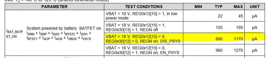

BQ25703A: BQ25703A Regarding charging
Part Number: BQ25703A
Hi TI team.
I use BQ25703A, but when I stop charging, 24pin (HIDRV2) and 31pin (HIDRV1) become 500mV and the connected FET turns on.
By turning on the FET, 700uA will be consumed and the battery capacity will be reduced.
Nch FET uses RTR025N05FRATL.
Please tell me how to solve it.
