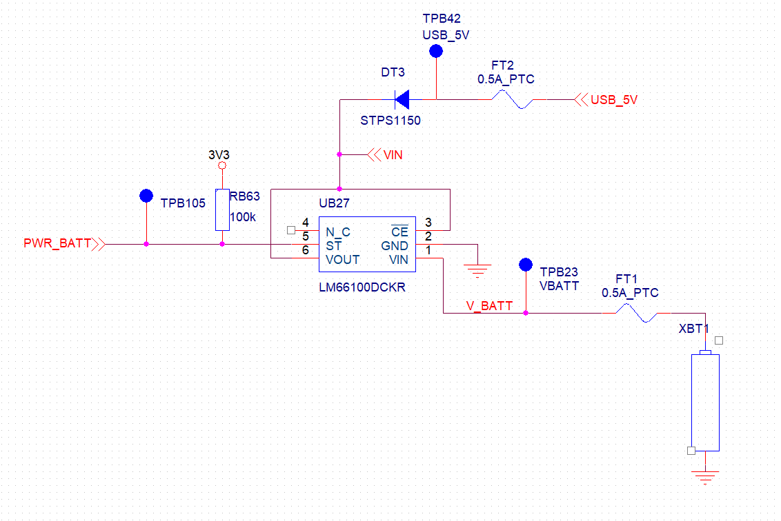

hello,
we have a design with one LM66100 to protect a battery (3.6V) from reverse current, alternative power source is USB with 5V.
with battery and no USB connected LM66100 works
with no battery and with USB connected LM66100 works
when using both power sources, LM66100 is not switching off the reverse current flow from USB to battery
I_rc=80mA
any ideas?
