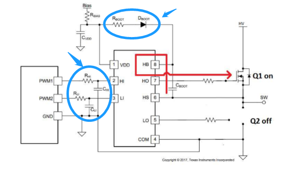

  • Hello, and I checked the relevant loop in the pdf file you sent me. I found that there is no component in the two circles shown in the figure below. Does this have any effect?
    In addition, I adjusted the size of the bootstrap capacitor according to the calculation formula, but the rising and falling edges still have not improved, and it is the same.

  • Hello Dailing,
    CSD18534 has a 17nC gate charge @ 10V Vgs that roughly equates to Cgate = 17nC / 12V = 1.416nF.
    Cboot must be >= 10*Cgate ~= 100nF for sufficient margin.
    CVcc must be >= 10*Cboot ~= 2uF
    RC Filter in input stage is optional assuming you have optimized PCB layout.
    Dboot (with Vbus minimum voltage ratings) on the PDF file is a must as it blocks high-side charging current from reaching the supply and allows the path in red and provides current path for charging boot capacitor (path in blue).
    Please reduce gate resistance to 1 or 2 Ohms and retake measurements.
    Please let us know if you still trouble with your design.
