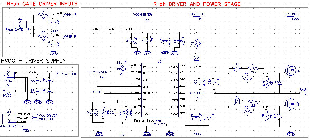

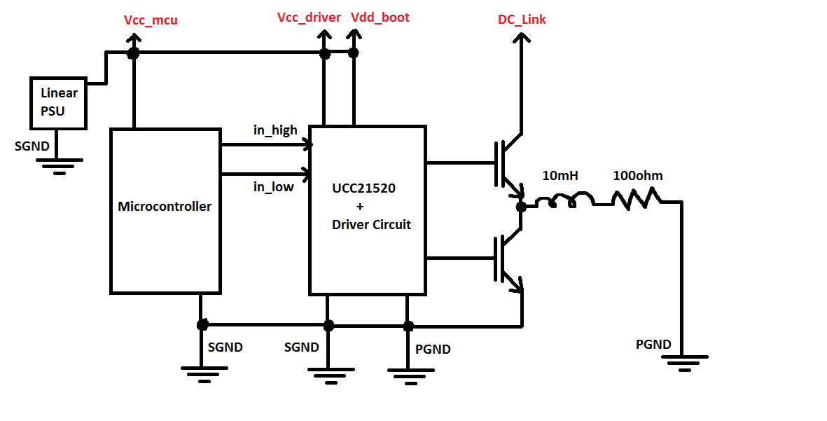

I'm using UCC21520 to drive one leg of a 3phase inverter. The block diagram of the system is -
SCHEMATIC

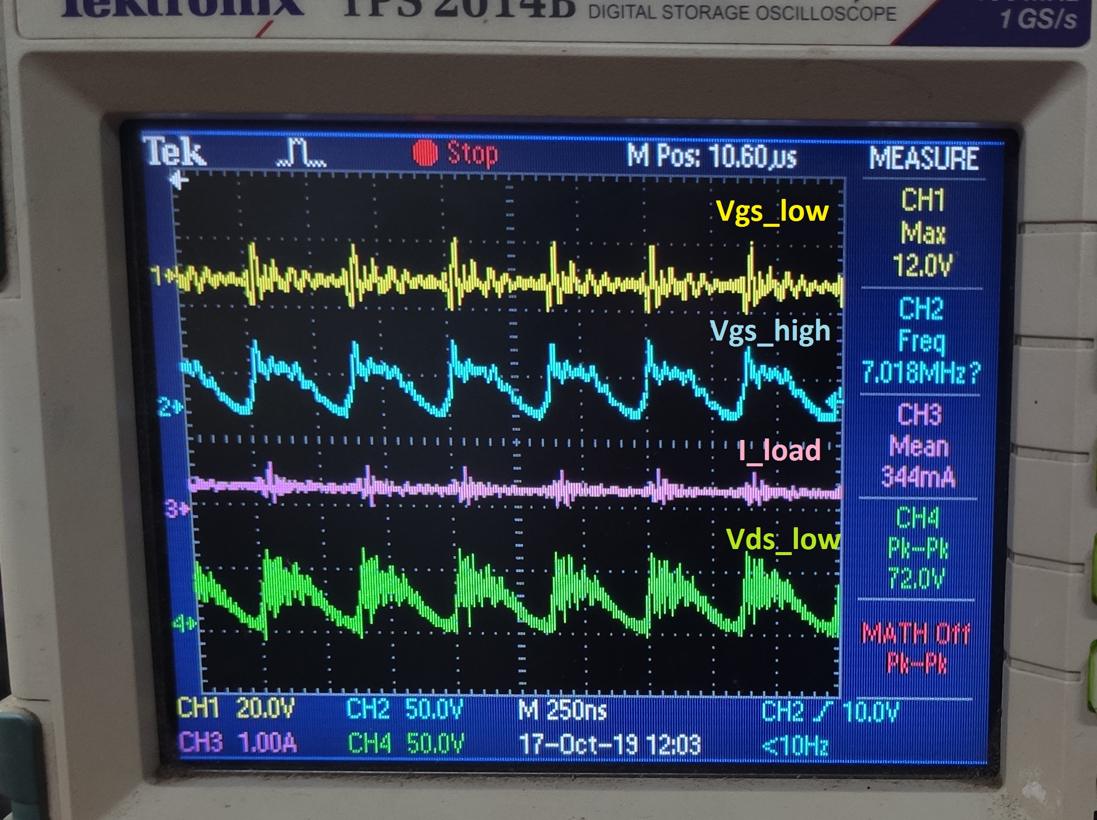

The high side and low side gate pulses are perfect when no load is attached and DC-link = 0 V. At no load, as DC-Link is increased, beyond 30v, I start hearing a strange hum from the gate-source loop. I'm unable to discern the cause, but this phenomena happens in other phases too. The amplitude of the hum increases as DC-Link increases. It sounds like a HF sine signal.
Things changes drastically when load is attached. At ~30v DC link, 10mh+100ohm RL load, the high side gate pulses get distorted, rapidly switching between high and low in the turn-on duration -
Vg_high is referenced wrt GND.
This phenomenon occurs only during High Side turn on.

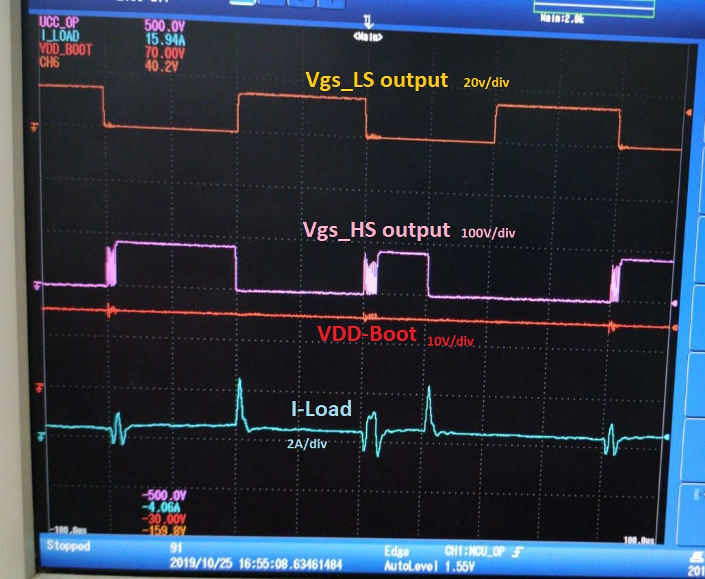

Zooming in on the waveforms.
This distortion occured at 30v DC-Link, 100ohm+10mH load. As load resistance is increased, distortion occurs at higher levels of DC-Link (does this have something to do with load current, di/dt issues maybe?)
Surprisingly, the same distortion gets reflected at the MCU side. The supply of the MCU gets distorted in the same manner. I tried changing to a new MCU board, put in bypass capacitors on MCU's LDO and VCC pin, but the problem still persists. (so, maybe the output stage of the driver itself is causing the problem?)
Out of curiosity, I increased the DC_Link further. The hum intensity kept on increasing with DC-Link and at one point, the hum stopped and suddenly the driver started behaving weirdly like this -
(Colour scheme is changed here, sorry)
YELLOW = HIGH SIDE (wrt to gnd)
BLUE = LOW SIDE (wrt gnd)
Even after multiple resets, the driver now always produces high side gate pulses in the fashion shown in the video. And now, this thing happens at DC-Link <15v, for load = 100ohm + 10mH. In the same turn-on period, the driver initially produces proper high side gate pulses and then just fails for the remaining duration of the on-time. This occurs periodically and only at the HIGH SIDE. Low side pulses are perfect!

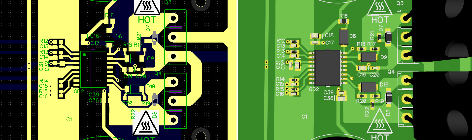

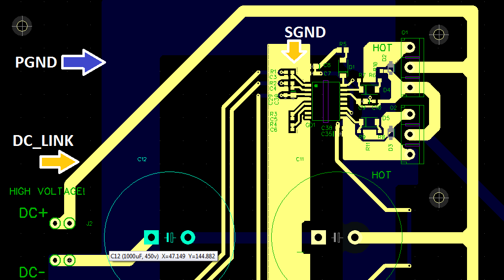

Here is a snippet from my board layout -
GATE-SOURCE LAYOUT
Layout with DC-Link

  • Hi Pranit,
    Thanks for your interest in our driver.
    Quickly looking at your schematic:
    -You're using an isolated driver but it looks like you may not the isolation given that PGND and SGND are shortly through the single Ferrite bead point.
    -Bootstrap cap and VDD cap must be sized appropriately typically for CVDD >= 10Cboot to fully charge the boot cap.
    -What is PN of the boot diode used? is it rated for the expected Vbus?
    While we're further reviewing your schematic and layout, please refer to the attached document to appropriately size the bootstrap components and the decoupling capacitors. Once we updated those components on the board, let's remove the load first and focus on the driver and IGBT at the same bus voltages previously tested to confirm or rule out the bootstrap components.
    https://www.ti.com/lit/an/slua887/slua887.pdf
    We will will review your schematic and layout to get back to you with additional comments and feedback early next week (Tuesday at the latest, Dallas time).
    Thanks.
    -Mamadou

    I'd like to ask, is there any problem in the layout? Is there any problem with the selected RC values on the board? I had a look at all the reference designs of UCC21520, and the gate driver designs they have are far simpler than what I have on my board. Only thing remaining to do is to isolate the signal ground and power ground. Apart from that, what other factors can be causing this issue?
    This is what my assembled circuit looks like (feel free to point out any issues)
  • Hi Pranit,
    It could definitely be a input signal integrity issue. Can you do a double pulse test and zoom in on each of the rising and falling waveforms? It’s also possible that the low-side FET is being turned on by parasitic Cgd capacitance which might cause switch node oscillation. What are the FET part numbers?
    This does look similar to the waveforms in this app note written by my colleague – which shows the importance of layout and filters.
    http://www.ti.com/lit/an/slua897/slua897.pdf
    You can also use the same layout best practices covered in the app ntoe for this driver. Comparing the schematic capture to the layout, it looks like the reference designators changed, so it's hard to correlate schematic to layout.

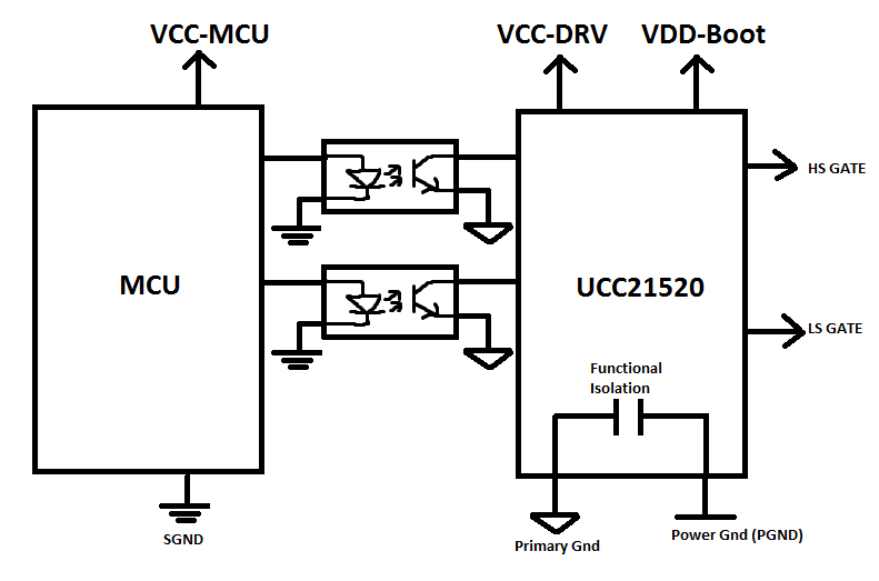

  • Hi John!
    Initially the circuit had only 2 grounds - SGND (MCU+ UCC i/p) and PGND (UCC o/p + IGBTs). Noise coupled from the power loop to the control loop. So, I isolated SGND and PGND, still the input integrity was compromised.
    Finally, I isolated the MCU, UCC21520 and power loop. I provided gate pulses to the driver via an optocoupler. So, now I have 3 grounds on my entire system - MCU gnd, Opto gnd and Power Gnd.
    MCU Gnd = SGND (only microcontroller here)
    Opto Gnd  = Primary Gnd (shared by opto output and UCC's primary side)
    Power Gnd = PGND (shared by IGBTs, DC-Link and Bootstrap supply)

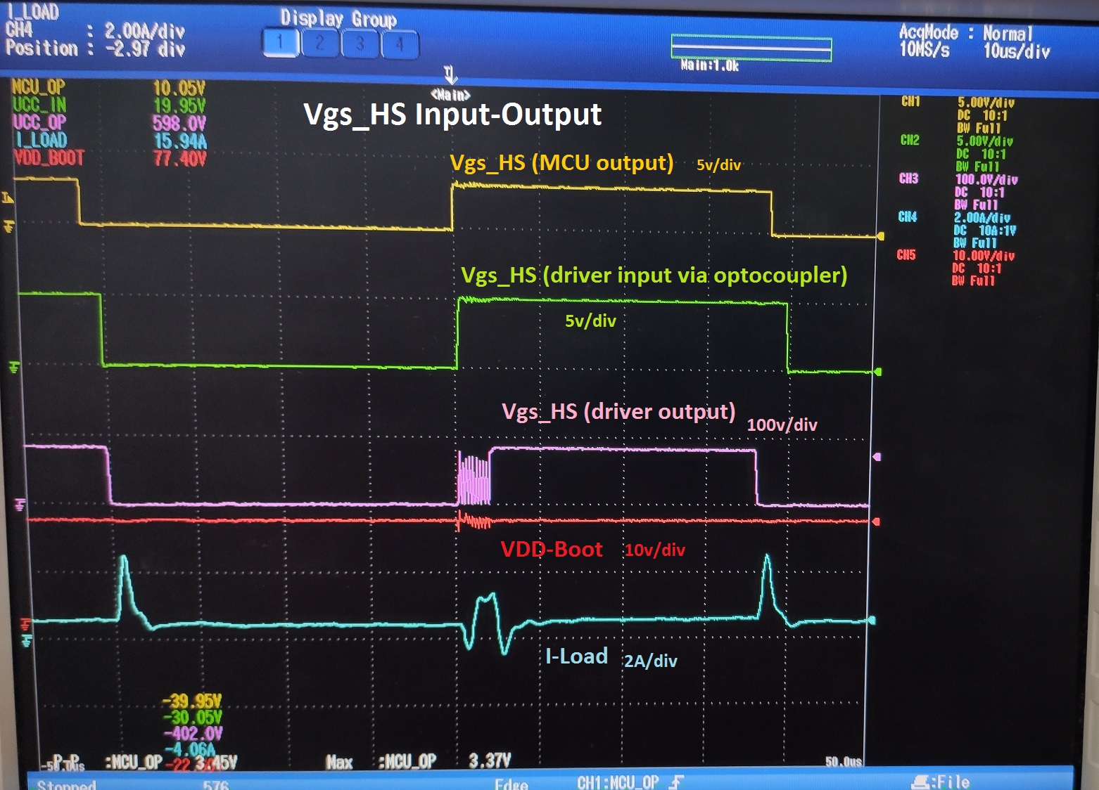

    The system works fine at 60V DC-Link. But at ~90VDC, I start seeing the HS output getting distorted, despite HS input being stable. I initially suspected two factors -
    1. Input signal distortion
    2. Bootstrap failure
    However, both of these were fine. It was only the output getting distorted mysteriously at 90+ VDC-Link. I'm attaching the graphs below
    ### Checking INPUT SIGNAL INTEGRITY ###
    ### Checking OUTPUT SIGNAL INTEGRITY ###
    Distortion1 (~80V DC-Link)
    Distortion2 (~100V DC-Link)
    Note that the Duty cycle of the HS output changes on its own, even when the HS input duty cycle remains unchanged
    I have Cboot = 100uF and VDD-Boot bypass = 100uF (oversized intentionally).This doesn't seem to be a failure due to input distortion. All inputs are good, all supplies are good and used as per TI's recommendation.. Layout is made as per TI recommendations. I even double checked the values and layout with the TIDA 00366 note and TIDA-01540 note.
    The entire debugging process is consuming a lot of time and its getting annoying. Kindly get back to this problem. I'd be glad if you could point out any issues in the layout

    What are the values of C6 and R4 on your board? We recommend using >2.2nF capacitor for C6. This helps improve noise immunity of the DT circuit. If noise is getting into the DT circuit, it could cause false triggering of the DT circuit.
    Also, your scope captures are being taken at a sample rate of 10MS/s. This limits your scope’s effective bandwidth and will mask higher frequency measurements. In order to truly rule out input signal integrity, you will likely need to take measurements with a sample rate > 350MS/s.

  • Hi John,
    I changed the DT capacitor to 330nF, the issue still persists. At high DC-link, HS output gets corrupted - switching ON/OFF at HF within its ON period. Complete isolation of primary and secondary didn't solve the issue either. In every case, the HS failed. Recently, beyond 140VDC-Link, the HS suddenly stopped giving any pulse despite its input being intact. Unlike HS, LS worked fine every time.

    Do you have a scope capture showing the dv/dt of your switch node? I highly doubt that these IGBTs were slewing faster than the 100V/ns driver spec based on the screenshot from your previous post. Looking more closely at the waveforms above, I think the issue could have been more related to dv/dt induced turn-on of the low-side IGBT causing shoot-through and overall poor performance. You can still see this low-side voltage spike when the high-side turns on in your updated waveforms as well, though it is probably mitigated by the higher gate resistance and slower dv/dt. I would double check that the gate-emitter voltage is being properly held down during switching and also check for shoot-through current in your low-side IGBT. For systems where high dv/dt is expected, we very commonly see customers use negative turn-off circuits as listed in section 9.2.2.8 of the datasheet, or single channel drivers with a miller clamp pin, such as UCC5350MC.

    About the LS Vgs spike, yes it's happening due to HS turn on, however, it isn't causing a shoot-through. If you look closely at the Vgs spike interval, I-load is still constant and also VDS-LS is rising. The spike in I-load is probably caused due to reverse recovery of body diode. Whatever the reason maybe, I-load spike is not due to shoot-through.
    About Rboot, I changed the diode (40v to 1kv) first and then operated the phase. Even after diode replacement, the resistor burned. So I replaced the resistor and now everything is working fine.
    About CMTI, even I feel its a herculean task for the IGBT itself to switch at 100v/ns slew, but since a TI lecture highlighted the exact same phenomenon and attributed it to CMTI, I think CMTI may be the culprit. However, is it possible that at high DC-Link Rboot somehow drew large current causing it to heat up and increase resistance (hence its inability to charge Cboot. Sounds irrelevant, but HS not being able to turn ON hints at BS output failure (Rboot, Cboot).
  • Hi Pranit,
    How are you measuring I-load? Usually, shoot-through current will bypass the load and drain through the low-side power device.
    Did you replace the resistor at the same time as the diode? The resistor could have been damaged at the same time as the 40V diode.
    John
