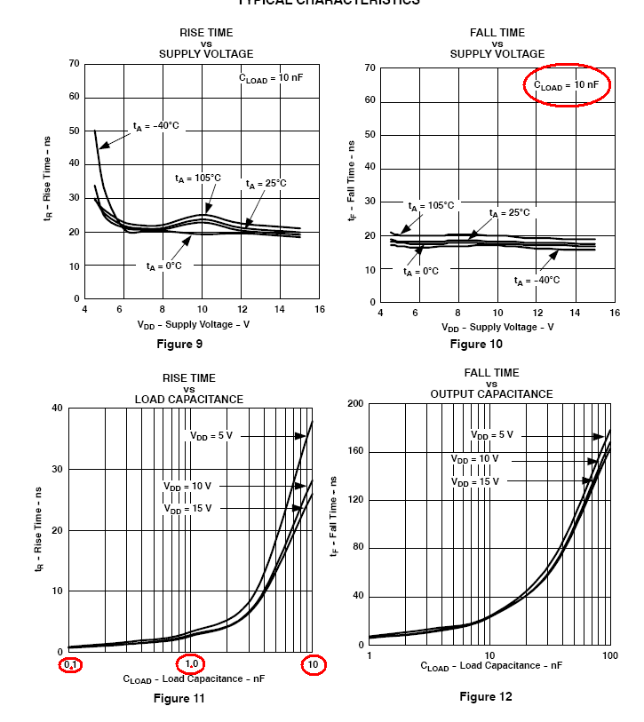

In the UCC27322 datasheet; ("http://focus.ti.com/general/docs/lit/getliterature.tsp?genericPartNumber=ucc27322&fileType=pdf") When CLOAD is 10nF, Figure 11 read from about 5ns, but Figure 9 read from about 20ns.
Which is correct?

Hello Kitano-san,
It looks like the systems engineer and the IC designer made a mistake in the data sheet.
Charge control law I=c*dv/dt calculates the rise and fall time with 4.5A of average current, 10nF capacitive load, and 12V of bias current should have a rise time of 22 ns. This would suggest that figure 9 is correct and figure 11 is incorrect.

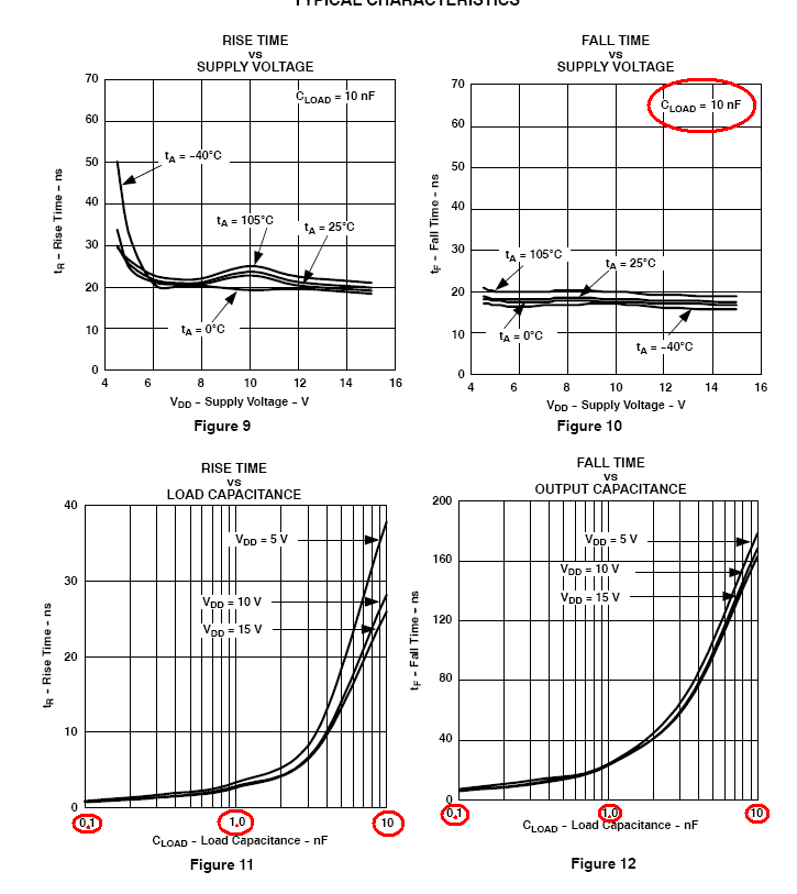

There are errors in the daa sheet on the UCC27321/UCC27322 part.
See the attached for the changes circled in RED.
After a second discussion with design engineering group it was identified that there are changes needed to figures 9 and 11 only of the specification for the UCC27321 (SLUS504E). These are shown in the attachment.
