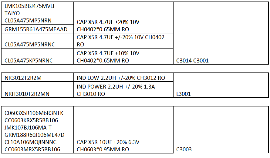

    Schematic looks reasonable but could you provide more detail about the cap, inductor and battery used in the schematic?

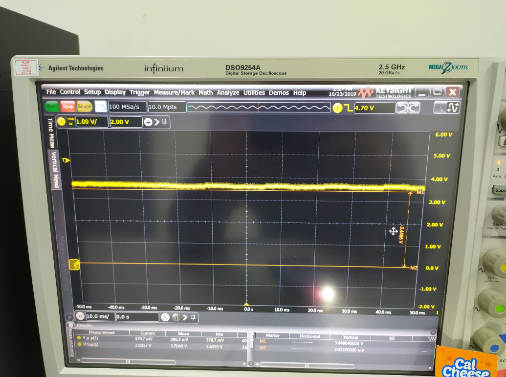

    The following is the reply to the question, please help guide, thank you.
    1.In the schematic diagram, the model of capacitor & inductor.
    2.Input and output waveforms
    (1)Input waveform
    (2)Output waveform

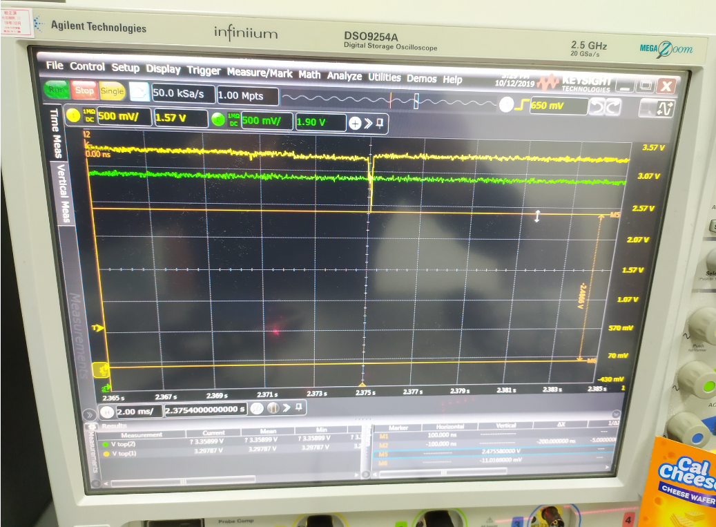

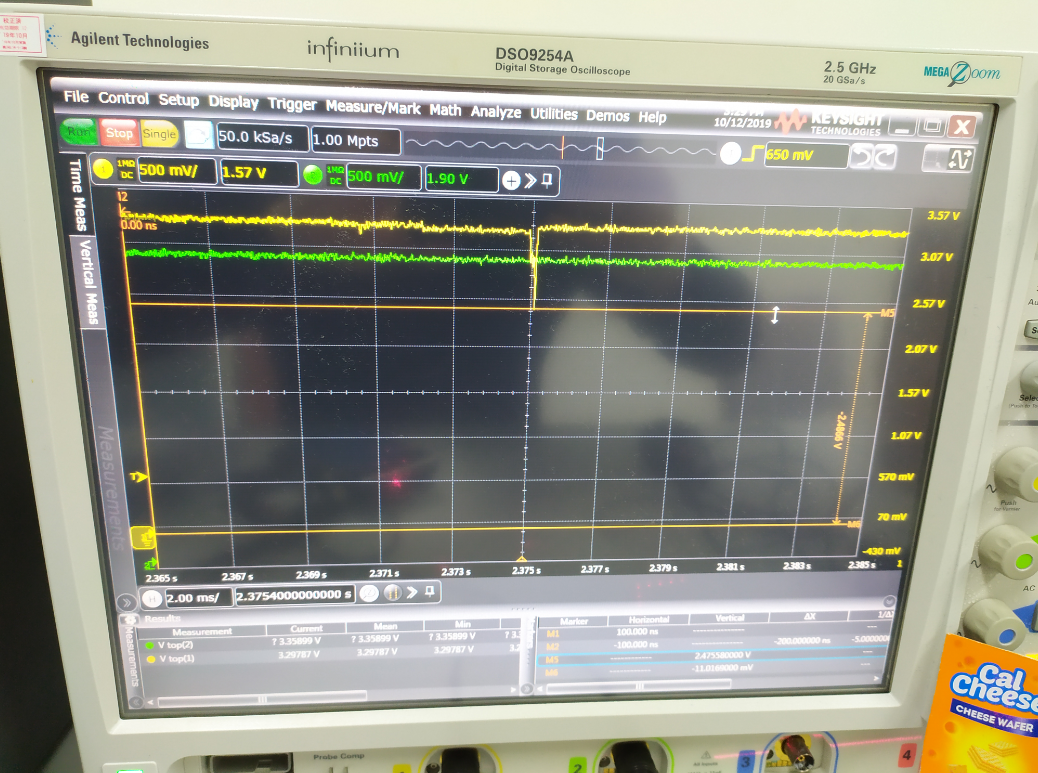

    In the second waveform, could you specify which one is output voltage and the point where the output voltage is dropping is it the point where are you applying the load? Could you share which point are you measuring the output voltage and could you also share the layout? If the information is confidential then I would suggest it to share it through the mail.
    Tanvee
  • Hi Tanvee
    1.The yellow waveform line is the output voltage (3.3v), the sharp one is the drop point (2.57v), and the green waveform need not be seen。

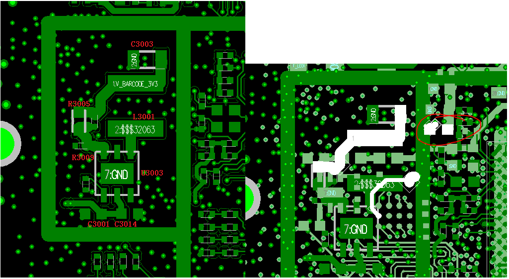

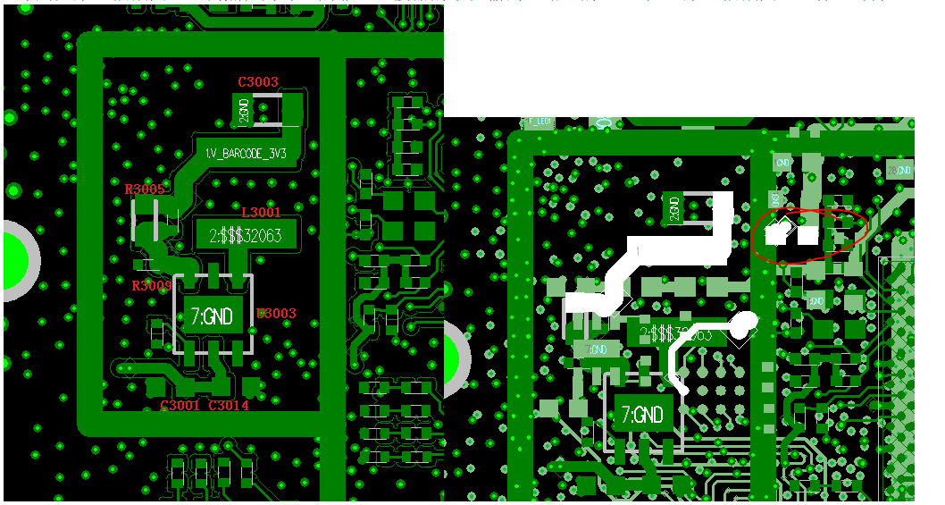

    2.The output voltage of the second diagram is measured with a constant load, but it is impossible to determine which is at the maximum load point, because the load varies with the power of the scan code.Layout as shown in the first screenshot, the measurement point position on the other side of the string near the connector is in the 0R resistance of the heavy output circuit (red marked part in the second screenshot).
    It seems when you scan the code, the max load is applied to the device with a very fast slew rate and making a drop in output voltage.  Thts the main reason I want to see the load waveform on the same conditions. Could you able to measure it in the output voltage and load at the same condition and try to measure the output voltage on the output capacitor (C3003)
