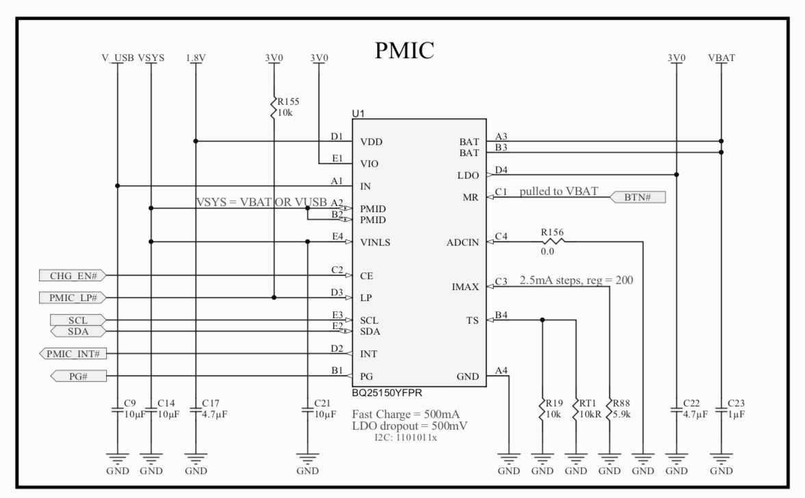

I'm testing the BQ25150 with several different LiPo batteries, and the CV phase of the charge time seems excessive. I have the pre-charge set to 77.5mA, the fast charge set to 500mA, and the termination charge set to 50mA (10% of fast charge). With several batteries now in the 900mAh to 1000mAh range, I see that the CV phase of charging lasts more than 3 hours. I expected the entire charging process to be around 3 hours, not just the CV phase. Is this expected behavior? What can I do to speed up this process?

  • Hi Gautham,
    The system idle current is ~30mA, so I would expect it to draw 30mA from USB during charging. Attached is the schematic of the BQ25150 on my board. We tested our register settings on the EVK and the charging time was much faster (and it line with what I expected). Do you see anything in the schematic that's a red flag?
    Sara
  • Sara,
    I see the issue! (well hopefully) The IMAX value you seem to use is limiting around 201mA of current. Which explains the +2x long charge time. Now do you actually see the current being around 200mA at 3.5VBAT?
    Can you try swapping the IMAX resistor with the value on EVM (10kohm) and give it a go?
    Rest of the schematic looks cool. Assuming I2C is pulled up to VIO as well.
    Gautham
  • Hi Gautham,
    I do see the battery fast charge at 500mA when in CC mode. My understanding is that if the Rimax value is 5.9kOhm, register 0x13 is set to 0xC8 (ICHG code = 200), and register 0x14 is set to 0x9F (ICHARGE_RANGE = 2.5mA step), the fast charge value will be 500mA. The datasheet says that the Rimax value determines the maximum ICHG_CTRL register value (decimal), which comes out to 201 in my case. So that means that the ICHG code cannot be higher than 200 (decimal). Is that understanding correct? Based on that logic, I don't think that changing the resistor value will change anything (but I will try tomorrow when I'm back in the lab).
