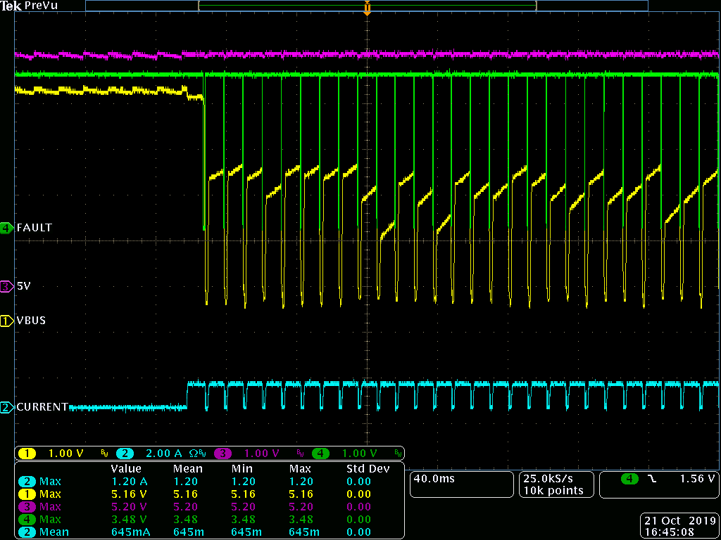

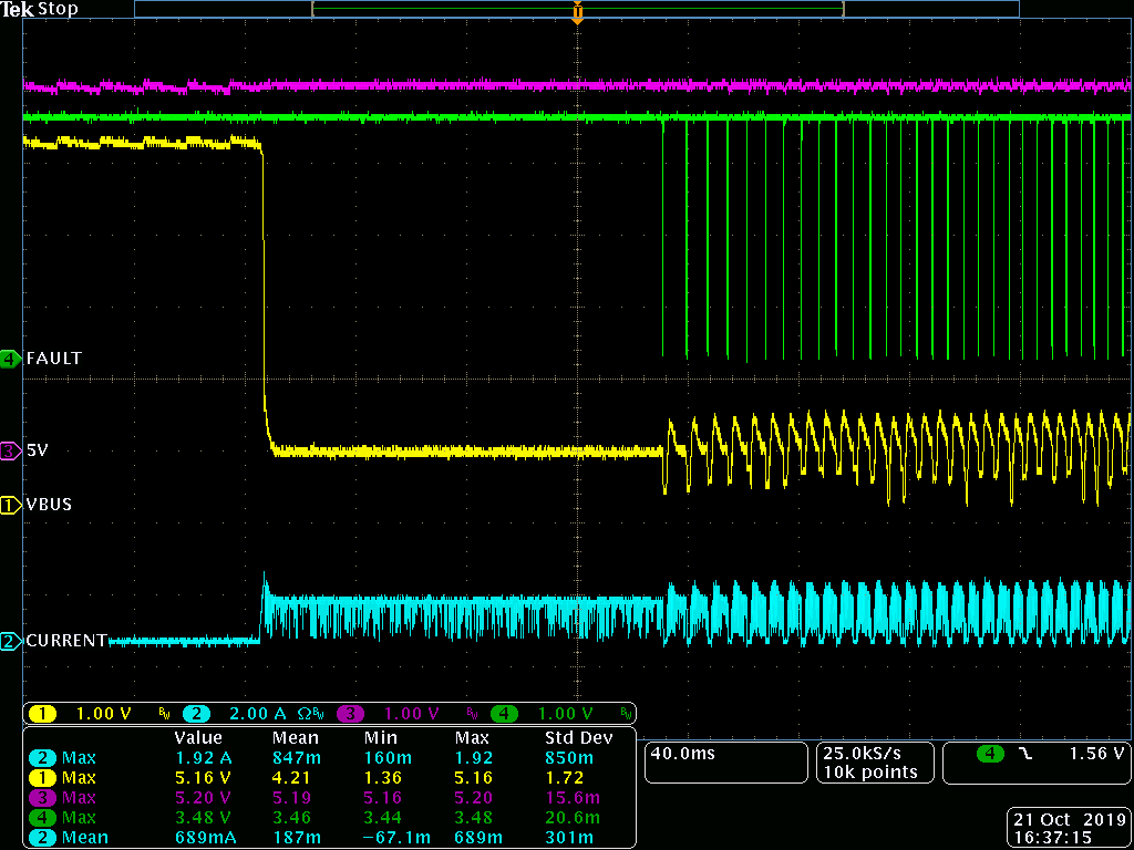

Dear Team,
Why the OCP at 3A the device fault signal will assert after 130ms?
But 1.1A will assert immediately
1.1A OCP
3A
BR
Kevin

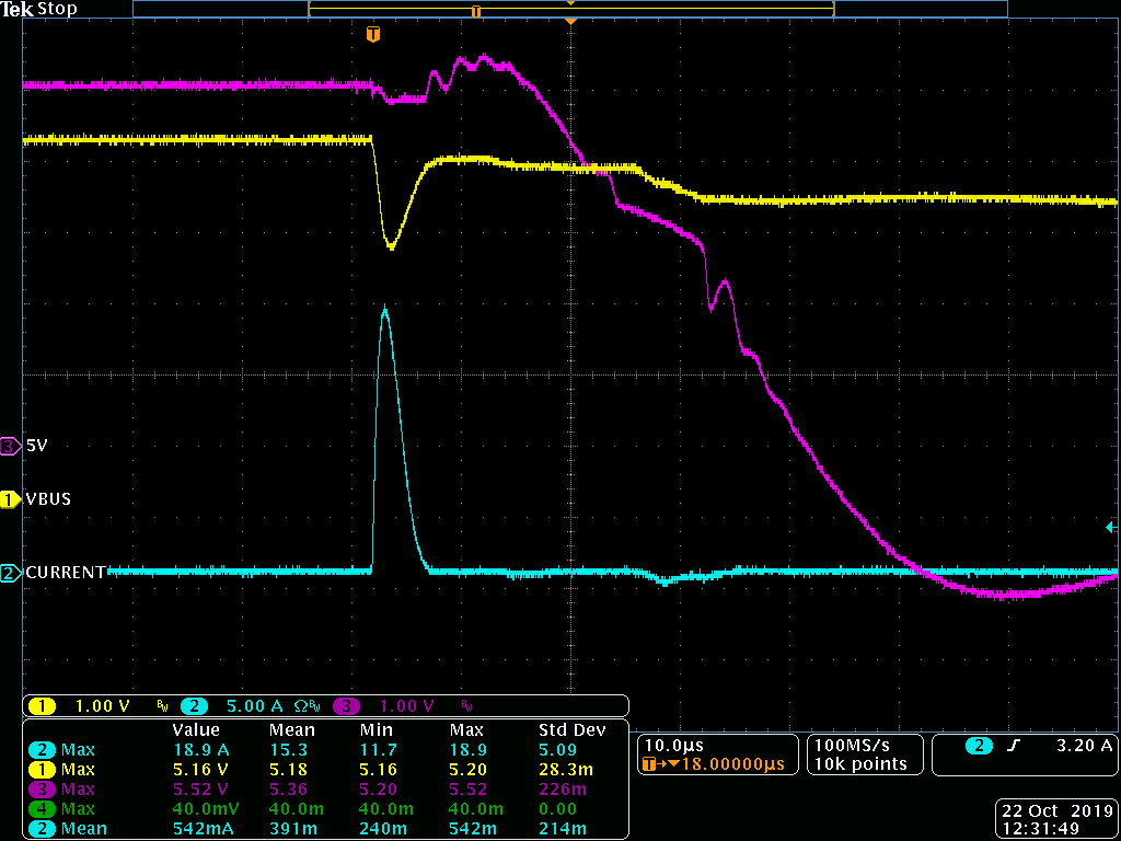

  • Dear Zhang,
    Thanks for the prompt reply.
    It seems the customer first inrush may up to 20A.
    Do we have spec. to define the maximum spike and duration time?
    Or you have better suggest device?
    BR
    kevin
  • Hi Kevin,
    For inrush current, the part has the current limit and thermal shut down function.
    It can protect the circuit even in hot short condition.
    We don't have the spec of the maximum spike but the part can response within tios=2us.
    For the 20A inrush current, the duration is short. Our part can protect it.

  • Hi Kevin,
    Hot short is the most strict condition for over current.
    It's the basic function to protect the circuit as hot short.
    Hot plug can be treated as with heavy load.
    It will not break the part.
    The only concern is pulling the input voltage drop.
    The part has tios=2us response time to limit the current.
    Before the tios, we don't limit the current.
    Does customer has the case being broken?
    Will click resolve first.
    If any, call me any time.
