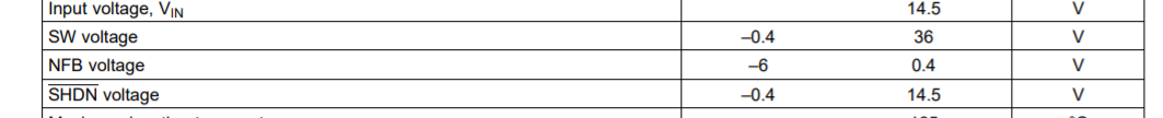

My customer, when testing SW voltage, found its negative spike lower than -0.4V, as which is the absolute rating noted in datasheet. Could you please kindly check if we have an AC rating for it? Thanks!

We never recommend to use the device exceed the absolute rating.
May you share the waveform for me? Sometime, it may just the noise caused by the measurement.
