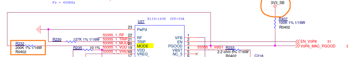

Hi E2E,
We use TPS53355 and let mode pin connect to 3.3V by 200k.
Does the SS time will be affect? How to adjust it?

  • Hi Yuchang,
    The key is  that datasheet  pull-high to VREG not 3.3V.
    Could you kindly let me know TPS53355 how to judge the SS time?

  • Hi Julian,
       To add to Yuchang's comment, the SS time is determined by the value of the MODE pin resistor. In your case, for 200k, the soft start time would be 2.8ms.
    Depending on MODE pin being pulled to ground or to a specific voltage determines the Skip mode or FCCM mode of operation. Based on description in section 7.4.1, if the voltage on MODE pin voltage is greater than 1.3V, then the converter enters FCCM mode.
    The reason for tying the MODE pin to PGOOD is such that during startup, PGOOD will be low. So the converter would be in Auto-skip mode.
    After startup, PGOOD will be pulled high. Which means that MODE pin will also be pulled high. This will cause the converter to enter FCCM mode.
    So, PGOOD being pulled up to 3.3V or VREG does not change the MODE pin operation. However, you should check your downstream logic to ensure that with a PGOOD of 3.3V, everthing downstream will work.
