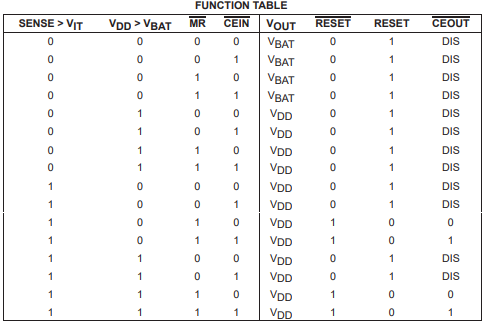

Could you please recommend how we should terminate the unused pins(SENSE, MR and RESET) for unused?

    Please see the function table and choose the conditions of Vout, /RESET, RESET, and /CEOUT they desire. This will help you decide whether to ground or connect the pins to Vdd.
    Abhinav.

    (1)The RESET pin is an output, the logic of H / L depends on VIT, VDD and BAT.
    What should the output be in this case?
    (2)Since MR pin is an input pin, should it be inactive H when not used?
    (3)The SENSE pin must be connected because it is necessary to determine whether VDD is higher or lower than VIT.
    Is it correct?
    I appreciate your great help.
    Shinichi
  • Shinichi-san,
    1) I don't quite understand this question. If this pin is unused, you can leave it floating since it is an output.
    2) Since /MR is an input, you are correct. You should be terminating this with a high signal.
    3) You're correct, you should be connecting SENSE to the rail you are monitoring to ensure it stays above the threshold.
    Abhinav.

    (1) RESET : Floating
    (2)MR : Floating  Because this pin is connected to VDD in the device, I think it doesn't need to connect device outside, is it correct?
    (3) SENSE : It should be connected to the rail with resistor.
    Shinichi
  • Shinichi-san,
    Your understanding is correct.
    Abhinav.
