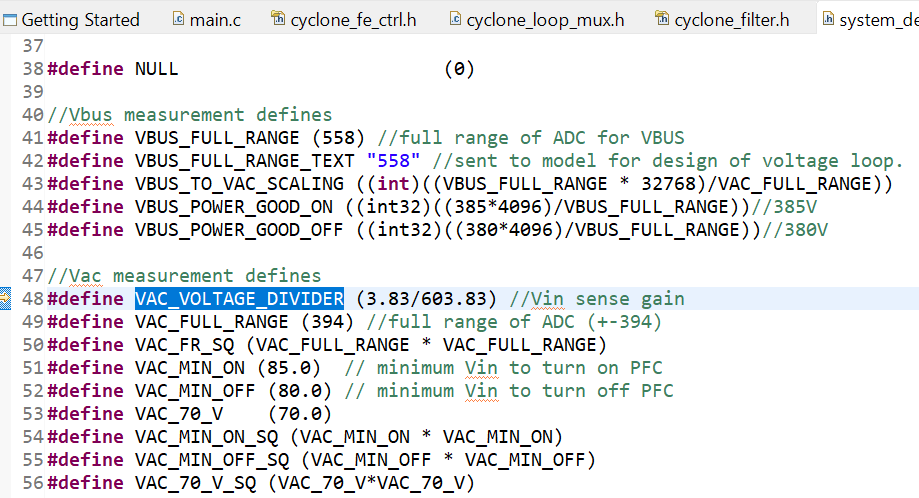

How does the #48 define?Could you please help me about it?
we use voltage divider to sense vin, 3.83kohm is the bottom resistor, 603.83kohm is top resistor + bottom resistor
