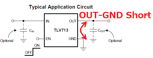

Is there test data for output to GND short condition?
If have, please let me know about two points below;
①Detailed test condition
②Temperature for TLV713 at short testing

  • HI Satoshi-san,
    Later today, I would have to confirm if they used a resistive load, or an electronic load set at a constant voltage to generate the below curve:
    The above graph is valid from -40 to 125C.
    What issues are you seeing?

    Thank you for reply,
    Additional information for temperature condition,
    I want to know temperature increase at the timing of Output shorting.

  • Hi Satoshi-san,
    I have been looking to see if we have data on short circuit response timing over temperature. So far, we do not have these details. What is driving this request?
