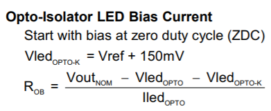

As for R421, it is the biasing resistor for the opto-coupler. This resistor is calculated by:
Where Rob is the resistor we want to calculate. This is taken from the application note fr your reference: http://www.ti.com/lit/an/slva305c/slva305c.pdf
It appears there are equations in the schematic that refer to some of the values in the above equation.
Michael Pahl
I don't understand the data of 150mV from what;
Vref =1.24V;
Vled=1.1V;
Iled=2mA;
Rob is calculated to 1.255K;
so I can make the Rob to 1.2K?
The equation is trying to calculate the voltage drop across the resistor. The 150mV is from the TLV431 datasheet, to take into account the voltage created by the current through the bottom biasing resistor.
I would factor this into your equation.
The 150mV is added into the equation for marginal error. This topic is discussed at length in the following post:
https://e2e.ti.com/support/power-management/f/196/t/323424?TPS23753A-Question-about-SLVA305C
It can be ignored, or changed if you want more margin in the design. Since your design is working I would confirm you could ignore it.
